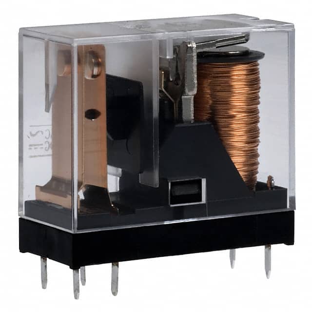

What you may need to do if the timers are "electronic" as opposed to "relay" or use a mechanical switch on their inside, is to use a relay (contactor) or two to keep the electricity from flowing "backwards" into the timers.
How a relay works...
http://www.google.com/#hl=en&source...ogle+Search&aq=f&aqi=&oq=&fp=eec9c32d20fe6232
A contactor is the same thing as a relay, but these are typically designed to be mounted in an electrical box instead of on a printed circuit board.
Contactor...
Relay...
