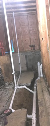

Hello Jeff and John,
Thank you Jeff for going out of your way to lookup NJ code.
I didn’t want to look it up because I know it would pass, I’ve done this type of install before as I said. My only concern was for drain pipe size that’s why I split the fixtures and ran a separate 2” for the Utility sink’s that’s going to be in the garage. I always look for the optimal solution that would work and my concern is usability above pleasing the government’s code.
This floor drain as with all the others I’ve installed are only to be used in an unintended and unusual scenario. I’ve installed at least 8 of these types of floor drains in the middle of the room for over 20 years and none of the floor drains had a drop of water in them except for the water from the primer.
I can install the drain against the wall and eliminate a horizontal run but that would cause issues because I have a purpose for every inch along the wall and having to access a drain from under an appliance would be just stupid regardless what the code says.
For this room I’m installing a large Viessmann Vitocrossal 300 boiler for the radiant heating/hot water in the house and a 42 gallons Viessmann Vitocell indirect water tank. The odds of the indirect tank rupturing are slim to none but I’m installing this floor drain in any case…
I didn't look up your boiler type. I would assume it's a modern condensing high efficiency boiler which needs a drain.
If so the floor drain is best near a wall so you can run your piping to it without piping laying on the floor. That's generally how we plan them, near a wall, but obviously not under an appliance.

Your supposed to use a condensate neutralizer with it. Mother nature doesn't want acid either. The directions will most likley show you using a neutralizer before the drain. It's usually required whether it's pumped outside or not. Apparently New Jersey doesn't care?

If your pan overflow and your T&P discharge is frequent you have a more urgent concern than your proximity to the floor drain.
The PH level of the condensate is around 5, Rhododendrons and other acid loving plants love a PH level of 4.5 to 5 this is why my observations of thriving shrubs of this kind make sense. You can look it up but trust me I’ve been into looking for how to best grow shrubs and trees in the garden for a couple of decades and I know first hand that the condensate isn’t harmful to some.
I’m not in the business of selling or benefit from the sale of pumps, as I said I’d rather not be hassled by an official; the worst thing that can happen is that the pump would fail and the alarm would sound, I’d be notified and would fix the glitch…

It’s illegal to drain highly acidic condensate in the sewer.
I gave this some thought. https://codes.iccsafe.org/s/IPC2018/chapter-8-indirect-special-waste/IPC2018-Ch08-Sec803.1 says "Corrosive liquids, spent acids or other harmful chemicals that destroy or injure a drain, sewer, soil or waste pipe, or create noxious or toxic fumes or interfere with sewage treatment processes shall not be discharged into the plumbing system without being thoroughly diluted, neutralized or treated by passing through an approved dilution or neutralizing device."
If you have plastic pipes draining into a city sewer, I don't see harm to the sewer system or piping. The condensate is low volume, and would be diluted once it joins other waste. So I would interpret this as not something that would destroy the pipes that this will travel through.
If it were outright illegal to run the condensate of your condensing WH or furnace into a drain, I suspect it is only if the instructions said you need a neutralizer, and the code said you had to follow the manufacturer's instructions. I could easily be wrong.
Now if you have copper drain lines, you certainly would not want that condensate. I would not even want undiluted urine in copper drain lines. Cast iron-- I don't have a firm opinion. The pH of the condensate is about the same as household vinegar, and I don't think it is illegal to pour vinegar down household drains. I understand that my pouring vinegar comparison is flawed in that condensate can be more continual, and pouring vinegar is a very isolated event.
If I did have a condensing drain and wanted to neutralize the condensate, I tend to not want to buy cartridges. Instead limestone gravel or calcite (water treatment grade limestone) could serve as the neutralizing media. I have no condensing furnace or WH. On the other hand, 803.1 says that neutralizing needs to be by an approved device. That would seem to forbid making my own, but may using an approved housing that I would reload with gravel would meet that apparent requirement. The fact that condensate could harm somebody's copper drain system does not mean that it could harm a plastic drain system.

This install is in a very upscale type of small town, they are very finicky about what goes in their water treatment facility. They also make a huge fuss about calculating impervious coverage and they go out of their way to propose and sometimes enforce drywell and stormwater management installations. The official is hard to convince and I stopped arguing because as I said I found the discharge to be an advantage for the landscaping. The trickle discharge from the pump is always beneficial to acid loving plants.
Way to make lemonade.
Think about flow during a hard freeze.
66
NYC
The discharge pipe is a 2” PVC even situated on the north side so it’s a worst case scenario with no winter sun exposure.. The setup is like this: A 3/4” PVC covered with black k-flex pipe foam insulation then sleeved through the 2” PVC. The PVC is painted to match the cedar shingles. Never once froze for over 10 years now. A couple years ago the temps fell to almost zero and the pipe never froze… I don’ half arse anything. Never.

It is always better to avoid an argument with an inspector.
He wouldn't argue a condensate neutralizer though as they are what is supposed to be there.
It's a better way to do it, it's really the only approved way to do it. They change out very easily and can be refilled with any limestone as there are different styles. A pump that pumps acidic water doesn't last too long.

In NYC last time I checked, you could avoid a floor drain vent if you connected within 15 feet to a vented drain. However trap primers might be required. On the other hand, I think if you connect to a storm sewer, or a building storm drain, no trap is required.
