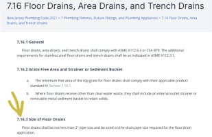

Wet venting floor drain in garage through a utility sink NSPC
66
NYC
I'm wet venting a floor drain in the utility room in the garage through the drain of the utility sink. The floor drain is a 2" drain with a 2" trap. The running length of the wet vent from the floor drain's trap arm to the long bend against the wall is about 11 feet. My initial install was to use 2" pipe but I ran out of 2" and I have a bunch of unused 1-1/2" pipe. PVC is 5 times the cost before fake covid so I thought I'd just use what I have...
I'm looking at the NSPC and based on 12.10.4 it's not looking good. Any thoughts?

So whats your solution ? we cant horizontal wet vent non bathroom fixtures jersy code allows it ?

Take a look at 12.6.2.1 2021 NSPC first time i looked at it your code allows the dry vent IPC dosent though and UPC is pretty iffy inspectors can and do fail them so your good in New Jersey . just use drainage fittings a Long sweep
if you had acess to the code dont know why you didnt check it.
