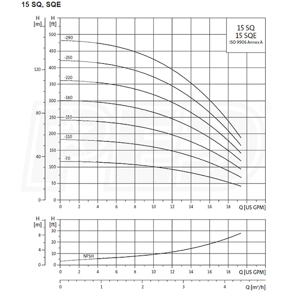

Pump set at 300'. static is 10'.
Grundfos 15SQE15-290
1" 200# poly drop and line to the house. Filter and softener not purchased or installed yet. Will likely go for a Fleck valve system recommended for this well performance. Here is the pump curve for the pump installed.

Yes. I am not sure where you would want to place that Dole valve, so solicit opinions. . Maybe somebody will think that you don't need one with your 10 ft static level.
I presume you bought a CU-301. Keep your warranty info. If it fails after warranty, you can consider https://cyclestopvalves.com/pages/replacing-sqe-or-cu301-with-csv
Dole is the original brand. But I see https://www.flomatic.com/valves/automatic-control-valves/flow-control/flo-trol-cd900/ (Flomatic makes good check valves). They show bigger diameters, tho 1 inch is probably big enough for you. to put 15 or 20 gallons through.

With the CSV and a small tank (10 gallon size) I don't think you need a Dole valve. Just don't use more than 18 GPM and the CSV will keep the back pressure needed on the pump. The 205 PSI on 200 PSI pipe is fine as the burst pressure of pipe is 2-5 times the rated pressure. Also that is plenty of pump to make up for any friction loss.

How would I ensure I don't exceed 18 GPM if I'm using a standard well setup with CSV? Would installing an 18 GPM dole valve right before a CSV play nicely together? Gain the constant pressure of the CSV while limiting the upper end of flow to 18gpm?

Without the CU301 box it is just an SQ pump, which works very well with a CSV. We replace a lot of CU301 boxes with a CSV1A and a pressure switch. You can have strong constant pressure from an SQ pump by just adding a CSV. Amazingly the amps of a SQ pump drop the same way (about 50%) when restricted with a CSV as when slowed down with the complicated and expensive CU301 variable speed controller.
The CSV works like a variable Dole valve. As long as you don't open up more than 18 GPM worth of faucets, the CSV will keep the pump from pumping anymore than 18 GPM. But if there is a possibility of someone opening too many faucets then an 18 GPM Dole valve installed WITH a CSV1A will let the flow be varied from 1 to 80 HPM max.

Would that really stop the pump from delivering 28 gpm before the pressure rises to the set point on the CSV?
