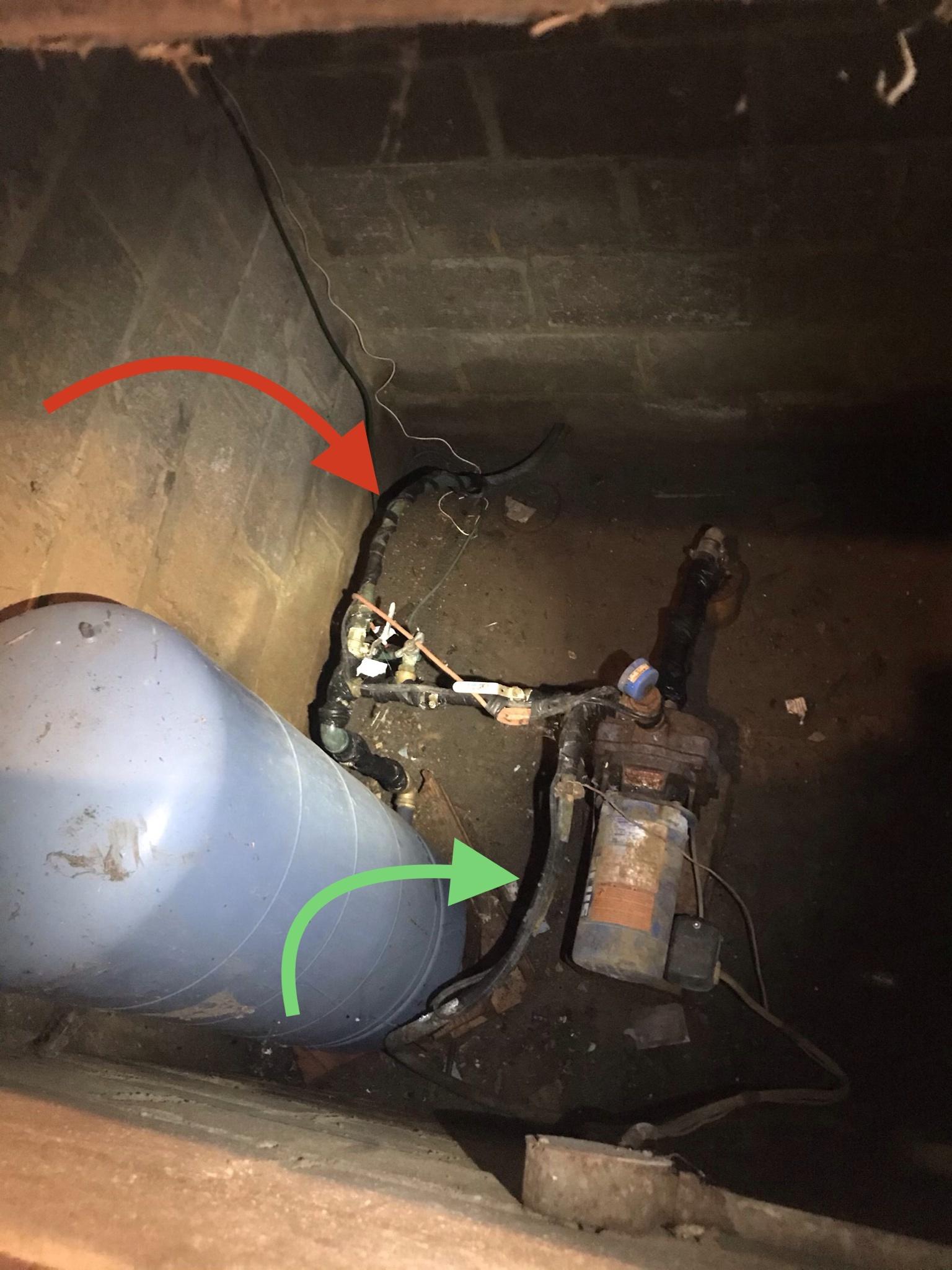

Hey guys. I'm wondering what could be done to improve the plumbing in my well pit. My issue I'm trying to resolve is I get about 2 GPM of flow to the house (red arrow in the picture is the 60-70' copper feed line to the house) and closer to 15GPM at the hydrant by the well pit (green arrow in picture). I need to pull all the heat tape and other garbage off to get a better look at what I'm dealing with but it looks to me like the line between the pump and the well tank is undersized. If anyone has any other ideas I'm more than happy to listen at this point.
Regardless of if this is my issue, what would you do if you had to overhaul this plumbing job? What type and size of fittings and pipe would you use?
Also unrelated to the flow issue, I've read that having the pressure switch hooked directly to the pump is not best practice. How should I plumb this in properly?

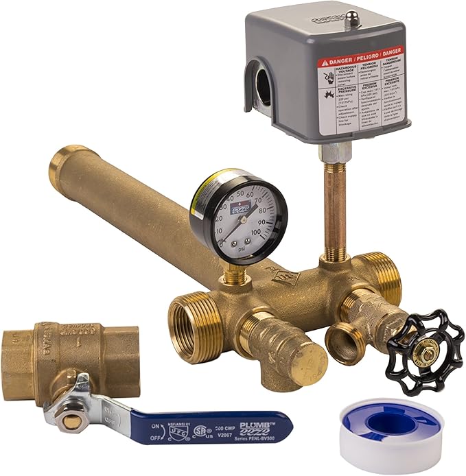

If you are getting 15 GPM at the tank but only 2 GPM at the house, the pipe to the house maybe corroded up and restriction the flow. Replacing the pipe and/or getting a pump that can build more pressure maybe your only options for more pressure at the house. However, just maintaining a strong constant 45 PSI from a Cycle Stop Valve instead of letting the pump cycle on and between 30 and 50 will make a big difference in how much you can push through corroded pipe. Replacing all that stuff with a PK1A kit would give you stronger constant pressure as it has a smaller tank. It would look something like this.

If you track the problem to being in that long copper path (is that 5/8 OD or 7/8 OD?) you could try running an electrical snake through it to either detect a kink or to push out a blockage.
If you continue to use the pit, consider putting a sump pump in there to pump out the seepage so that contaminated water does not enter your well.
Green arrow does not point to a hydrant.

Sorry, I meant to say the green arrow points to another copper line which feeds a hydrant next to the well pit that produces around 15GPM. Not that the line itself is a hydrant. Copper is 7/8" OD
No filters inside the house. The same line T's off in the yard somewhere before the house and feeds a couple yard hydrants which also produce about 2GPM. If any of my outdoor hydrants are running, there is zero water flow in the house and you can actually hear water siphoning backwards if you open a faucet in the house.
Fish tape down the line seems like a good idea. I wonder if there's some corrosion where the installed the T fitting in the yard or something of the like.

Your property layout drawing does not specify if the line highlighted with the 'green arrow' in the earlier photo, is the same line supplying the barn and chicken coop. If so, the property layout is not accurate.
There are a few issues noticable within your pit photo.
Galvanized steel fittings should not be utilized with copper. Galvanic corrosion as a result of the contact of two dissimilar metals, will often result in the steel fitting to corrode internally at an accelerated pace. While the elbow located at the bottom beside the pressure tank is clearly brass, the elbow above and the Tee where the pump supply, house feed and pressure tank supply merge, appear to be galvanized steel. It's not clear if each of those fittings are in contact with copper, but all steel fittings need to be removed and replaced with more appropriate materials
If there is corrosion within either fitting resulting in a partial restriction of water from the pump, then water will not enter/exit the pressure tank as rapidly as it should be. If the restriction is within the Tee, the flow rate to the house line will be reduced, which is often reported as low pressure.

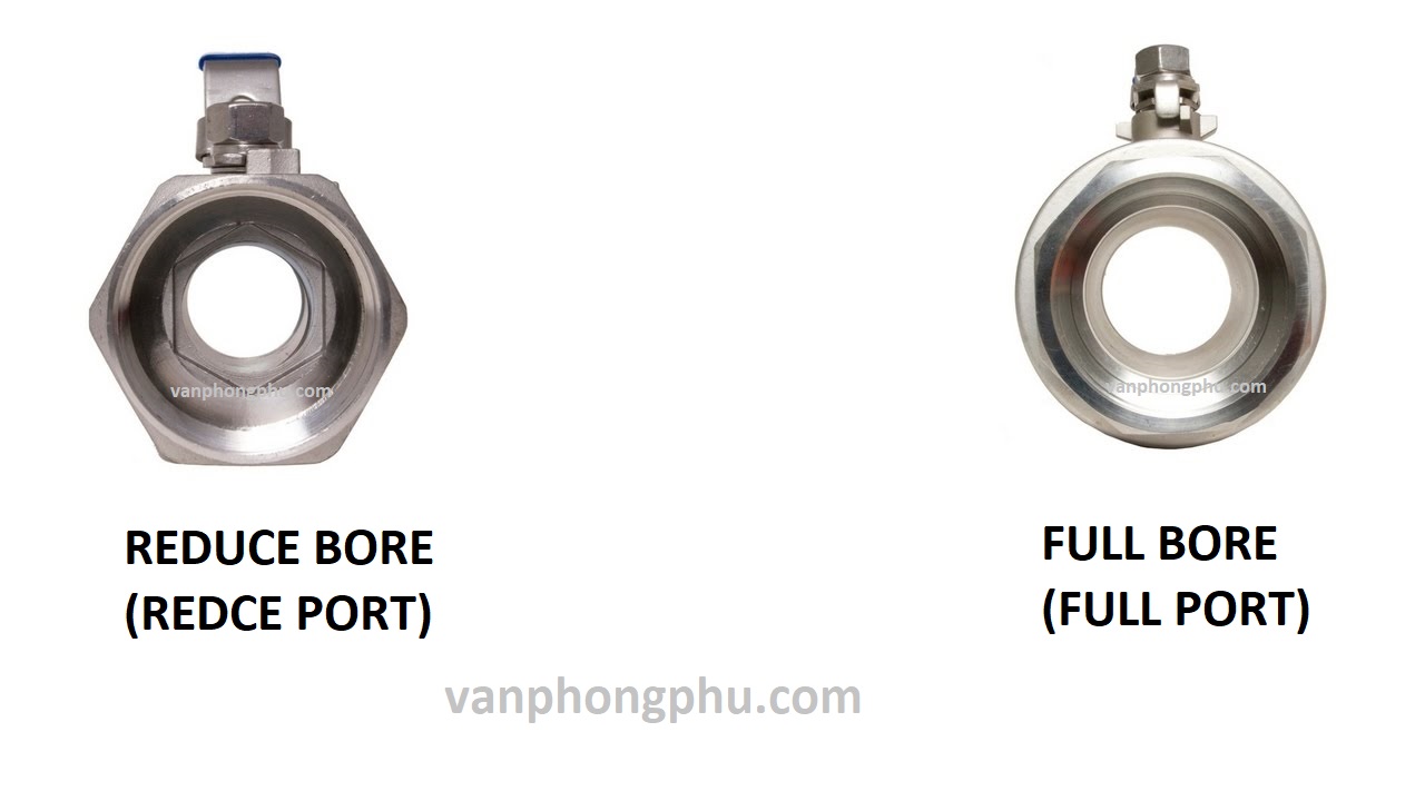

Although there are multiple ball valves observed, they may not be all "Full Port" valves. Suggest replacing any standard/ reduced port valves with full port versions.
As you mentioned, the pressure switch should not be sensing the pressure directly from the pump, but is to be rightly sensing the pressure from the pressure tank. The existing pressure switch maybe physically relocated to the pressure tank connection, or the pressure switch may remain where it is presently located if the sensing tube is extended. The connection at the tank is usually performed using a Tank Tee as shown below.
Because the location if the restriction is somewhere after the 'green arrow' Tee, water use through the 'green arrow' line is likely resulting in the pressure at the pressure switch to rapidly drop to the pressure switch cut-in pressure, thereby causing the pump to become activated so as to supply the 'green arrow' line at the pump's full flow rate.

Apologies that this wasn't made clear. The green arrow line is feeding a single hydrant next to the well. The red arrow line feeds the house, the barn, and the chicken coop. The barn and the chicken coop hydrants suffer from the same flow issues as the house.
Everything you said makes sense and fits the symptoms of my issues. I have noticed when I turn the green arrow hydrant on, the pressure switch almost always immediately kicks in which would be consistent what you're saying.
I'll plan on replumbing the old potentially galvanized fittings and making sure those ball valves are full flow. I'll also either install a tank T for the pressure switch or purchase the CSV kit and remove the old tank altogether. Would poly pipe be an acceptable replacement or would you suggest something else?
