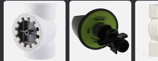

Yessir. That will work. If you can make room for one I’d still try to fit in a clean out where you’ve got a 2” coupling just above the concrete. If you’re required to put a head pressure test on those fittings for inspection you can use a Holdrite test tee that works very well for test.
