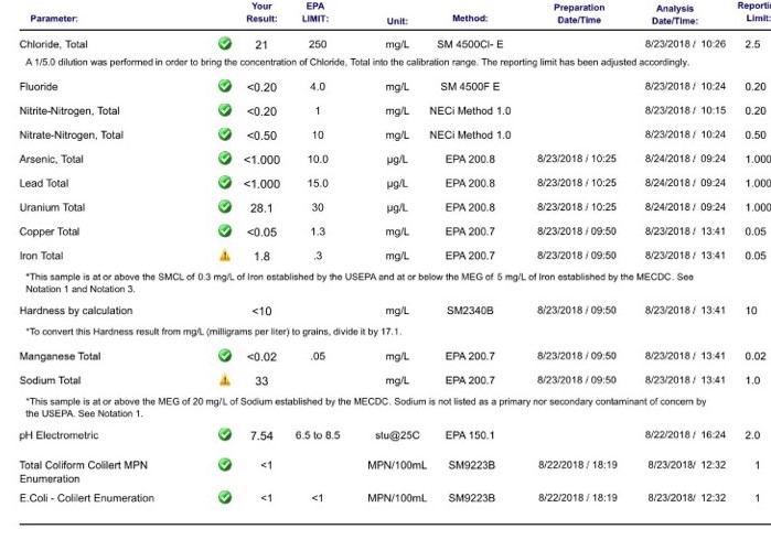

I actually don't have a raw test but I have a test after the water softener, a 5 micron sediment prefilter, and the radon bubbler, attached. Regarding hardness I tested with strips myself and got 150 mg/L and confirmed that post softening it came down to 30 mg/L as specified in the display.

The large quantity of Iron measured in the softened water suggests the resin maybe fouled with iron deposits. Suggest cleaning the resin with an acid cleaning solution such as Super Iron Out or citric acid. Initiate manual regeneration and advance controller directly to BackWash. Mix strong solution using 2-gallons warm water in bucket and add solution to brine tank when the Brine Draw cycle begins. Once the warm solution has been transferred to the resin tank, unplug electrical power and bypass softener to allow resin extended time to soak in cleaner. After 1-1.5 hrs, un- bypass and restore power to allow softener to complete remaining regen cycle. Initiate a second manual regeneration and allow to run uninterrupted until completed.
Suggest to obtain a lab test of the raw well water. Without knowing the accurate amount of hardness, iron and manganese and other conditions prior to treatment, we can't determine if other treatment methods will be required or the appropriate hardness setting to be programmed.

While a softener may be utilized to remove iron, because 1 ppm iron is equivalent to 85.5 ppm hardness (5 grains/gallon) capacity, a softener is not an efficient iron removal method. For this reason, a softener is not usually used for iron removal unless the iron amount is low. Because 1.8 mg/L (= 1.8 ppm) iron continues to remain after the softener, leads to the question, how much iron is in the raw water?
As 17.1 mg/L is equivalent to 1 grain per gallon hardness, assuming your 150 mgL/ppm test strip result is accurate, that will be 9 gpg (8.77) actual hardness. You have not specified the hardness setting so I calculated the current setting likely to be almost 30 gpg which could be that high to compensate for up to almost 4 ppm iron.
With considerable iron, the regeneration frequency may need to be more frequent, possibly as much as every 3 days. Until a lab test is obtained, recommend reducing the capacity & salt setting, and perform the resin cleaning and additional regeneration recommended earlier, The settings should be reviewed and possibly modified again after the test results are obtained.

your water test is from 2018, but you said you didn't notice any water problems until recently? with 1.8ppm iron in the finished water the entire time? please clarify when the problem first appeared. something doesn't add up.
Skyjumper
214
11
Midwest
oh - if your finished water really has been at 1.8pm Fe for 2+ years then your resin is completely fouled and needs to be replaced. or better yet, get a new softener. no amount of resin cleaners in the world will clear that thing up.
I theorized in another reply that maybe it was so high due to lack of softener upkeep. Additionally I'm pretty sure they weren't as good about replacing the 5 micron filter because there was one set aside that had been wiped down as if it was going to be reused again, and when we moved in the filter was extremely dark with iron, so the test had been a sample collected that passed through that. Point being, perhaps the iron ppm was inflated for one or both of those reasons.
I understand a new softener might be on the table and I'm open to that. It can't have been too badly damaged though as at the servicing roughly a year ago nothing was mentioned about the media being overly fouled, to replace it or the entire softener.
One thing that changed as of that servicing is it was suggested to close the sediment prefilter about halfway so the radon bubbler doesn't pull water faster than the water softener can work/at least give it more time for the water to be treated. It had previously been open all the way and pulling at I believe 6.5 gpm per the display, now does between 2.5 and 3 gpm.

...so the test had been a sample collected that passed through that. Point being, perhaps the iron ppm was inflated for one or both of those reasons.
I understand a new softener might be on the table and I'm open to that. It can't have been too badly damaged though as at the servicing roughly a year ago nothing was mentioned about the media being overly fouled, to replace it or the entire softener..
ok, but it still went through the softener, and the softener passed 1.8ppm, and from what I gather you haven't done any softener cleaning since? correct? I mean, aside from just recently using morton rust salt, which is like using baby shampoo to clean up the exxon valdez spill.
just get a new softener, and use resin cleaners from day 1, with every regeneration. but you do need a raw water test too. if you've been reading this forum you know I'm the world's biggest clack fanboy so I won't repeat the benefits of Clack systems here. but get a clack...

Resin or softener replacement may not be required as hardness removal with only <10 ppm hardness in the softened water is reasonable. After resin cleaning, I anticipate the remaining hardness amount will likely be lower but below 17.1 ppm hardness is considered sufficiently soft for residential applications.
A Hach 5B Total Hardness Test Kit is recommended for periodic testing of both the raw water and softened. The 5B will report hardness as GPG which is usually sufficient but they also offer other kits for measuring ppm if necessary. These test do not replace the necessity or a comprehensive lab test.
If you don't already have a preferred lab, National Labs offer a Standard Well package which is will be appropriate.
