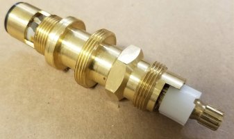

Hello all, I am usually good at finding stuff like this but I have officially failed!
I have a bathroom we are remodeling and was planning to replace the trim on a 3 handle valve with these stems installed. Well, after buying 2 different kits that both don't fit I am out of ideas. Can anyone point me to a trim only kit that will fit these? Pic is attached
Follow up, if I can't get the trim kit for these, can I use one of the rebuild kits with different stems? Again, I believe most of the common ones are for a "verve" model.
TIA!

Your stems are Price Pfister ceramic stems. You should be able to find a basic trim kit to fit at your local Home Depots. For More decorative trim kits, try your local mom and pop plumbing supply house .
good luck.

Huh, I had tried to repy previously but I guess it didn't go through.
So, yeah, I have searched high and low for a trim kit for these with no success, do you think you can link to one? I basically can only find kits that fit "Windsor" or "Verve" models, which seem to have a more common narrow stem.
My question, barring the trim kit is whether those other style stems will fit this valve body? It looks like they have the same style base? I would prefer not to that as it's an older unit in a rental and the existing parts all function fine but if that's what needs to happen...
TIA!

looks like home depot has discontinued the price pfister trims. Here are model numbers of a 2 handle and 3 handle set that is compatible with your ceramic stems. (see below).... lowes has the three handle in stock and it looks like you can order online, be aware the brass "good version" of the price pfister ceramic stem is now replaced with a cheaper plastic version. (see pic below) ...These kits only come with the rough valve, so until you find a local mom and pop store that can help you with just trim....you will have to buy the rough valve again even thought you dont need it.
good luck
