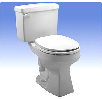

Our 3, 15 year old Toto 1.6 gal toilets have been having problems and need constant plunging and multi flushing. The plumber says it is the toilets themselves and not the plumbing. Any idea how long the suction on these is supposed to last? What are our options? Do we need to replace the toilets or a part inside? thanks

The CST703 was a builder grade toilet that TOTO sold.
MaP was 550 grams when new.
It had some tight bends on the lower trapway, so over time, you may have collected some stuff there.
You may be able to auger out the trapway.
Or if you have lime in the water, you may need to clear some rinse holes.
Either way, it was a $99 toilet to start with.
