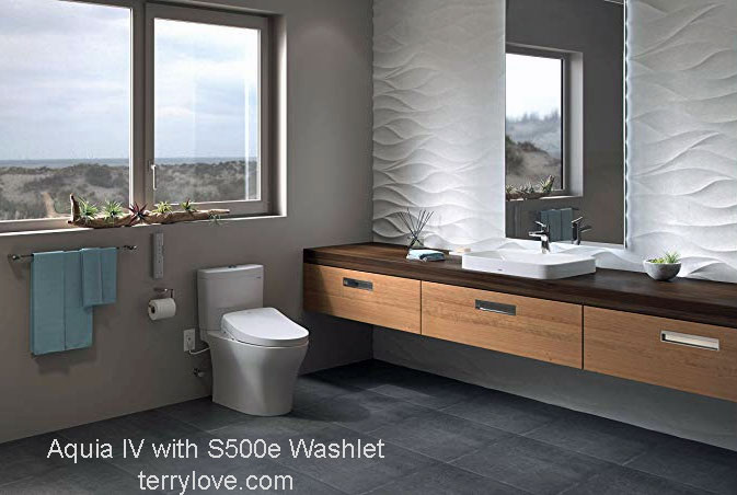

I like the Aimes and the Legato from TOTO.
Nice style and they work very well. They come with the Unifit adapter which allows a change to 10" or 14" if desired. A 1.28 GPF bowl with the swirl rinse.
Better quality control than many of the other brands too.
This picture was taken in Vancouver, British Columbia.

I hate the Aquia and will not install because of: small water spot and real stupid floor mount plastic blocks.
I've installed hundreds of them, and have the proper tools and the skill set for them, not everyone does I guess from the postings from other plumbers. I'm the plumbing wizard though, and my son Jamie also does a killer job installing them too.
We also do installs for builder grade toilets like American Standard too.
The Aquia bowl is more shallow than the bowls set up for 1.28, more of a European setup. They do work well though.
