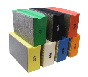

Thanks, Roberto. :) That's exactly the kind of picture I was hoping to see. It looks like you wrapped that corner, and kept the texture continuous. Absolutely perfect. That niche looks crazy clean, and tight.
Do you do anything to the sharp, mitred corner? I've read you and John talking about microbeveling repeatedly in the past, but couldn't pick up on exactly what it was, or even when that technique was applied.

The micro bevel is done with a diamond sanding pad. These do a good job to making the cut miter corner look like a new factory edge.
The 50 pad and 200 pads my two favourite. 50 first. 200 to clean it up.

Look close in this picture from an old tip of mine. See the mitred corners. See the gap between the tiles. I often make the bevel not 45 degrees but rather 50-60 degrees. This allows the grout a little more room and makes for a slight dovetail shape.
