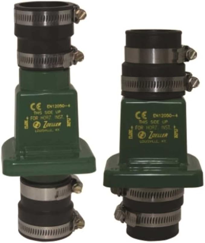

So how about the picture on the right? This is not what I was saying previously.
RMO194
44
Kansas City
New picture...
So, it appears the rubber ends are reversible? I'm confused--are you recommending I flip them to look like the second picture? Currently, mine looks like the first picture (although the two worms are side-by-side, rather than one near the green body and one at the end of the black rubber opening.
Tuttles Revenge
4,459
1,575
No. The rubbers are in the correct position. They transition from the 1.5 ABS pipe to the 1.25" check valve. Just the worm drive clamps were placed on the 1.25" half. One clamp at each end of the rubber adapter is what is needed.
41,382
4,990
The wide end of the rubber adapter is meant to connect to 1-1/2 inch pipe. RMO194 has 1-1/4 inch pipe.
41,382
4,990
I made a mistake. I will edit that to say 1-1/4.
