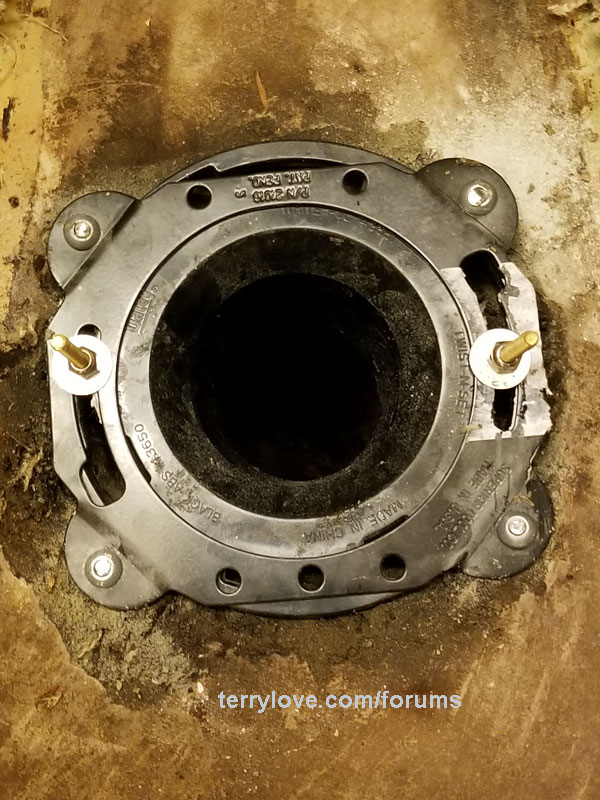

I have limited plumbing experience, gained only by watching tradesmen as well as YouTube. In short, I installed a 1/4 inch spacer to fix a broken PVC flange per suggestion from someone at Home Depot working part time who claimed to be an unemployed union plumber. I'm not sure of his skills, and he responded so lethargically and with odd pauses as if he was on drugs. I questioned three times if I should use a stainless steel flange repair kit and he just shrugged and said I could use either. However, I'm not sure I can squeeze such a piece into that tiny space provided by whoever did the tile job.
Following his advice, I drilled the concrete under the original flange and affixed the spacer with four Tap-Con concrete screws, drilling straight through the old flange which I left glued in place. Please see photos.
I used a Fluidmaster rubber seal, thinking it was better than wax and since I could reset it if it leaked. Of course, it did, and water came out very slowly from the front part of the toilet base. I then removed the toilet. I tried to remove the sticker on the spacer flange, thinking that might prevent a seal, but it would not come off, leaving gunky residue. I aborted removal of the sticker.
I did not bother to see if the new spacer was level. When I bolted the toilet, it did not move. I did not use any shims. I do not like to caulk the bottoms of toilets because of the look, and did not caulk.
Understanding the problem from the above, coupled with the attached photos, what is wrong? I appreciate your replies.

Your PVC flange is broken. BUT, since you are using notches rather than slots, you will need to cut away part of the ring of the PVC flange before putting the repair ring in place. Then use the slots on the repair ring to hold the closet bolts down.
There is a different kind of repair ring also, but still not one for notches. Can you drill your tile easily enough? If not, hold the repair ring down with screws that don't go thru the ears. The repair rings with ears also have holes in addition to the holes in the ears.

If you are keeping the plastic spacer, but want to reduce the height, discard the black part of the Fluidmaster product, and keep the blue. That is how they designed it to fit different gap sizes.

Please advise what this is, Terry. I like it. Looks tough, like something military grade. I see two pieces, but the bottom is made in China and looks broken. Is the USA-made piece on top the repair part, or is this sold as some type of set and the bottom is not broken?

I am calling the 4 legs that would spread out over the tile "ears". They each have a hole that could be used to hold the repair ring down. But there are other (alternatives) holes that you could stick screws through. Thus the ears would be over the tile, but screws through the other small holes would only go through plastic to the concrete. So that avoids drilling the tile.

I just figured out what you meant by ears and holes in the ears. In Terry's last photo, for example, I see the ears which I could not use unless I was drilling the tile. I'd be afraid of cracking it. Maybe I'd get lucky and do a good job without cracking it. But if I were not using the ears on that one, the four other holes might not properly support the two bolts holding the toilet, right?

The closet bolts would go thru slots in the repair ring, not round holes.
The screws holding down the repair ring don't have to match up with any other holes. You drill right through smaller round holes in the repair ring, through the plastic and into the concrete.

I think your problem Harold is the spacer doesn't get sealed to old flange and water gets between the 2 and leaks out. probably would not have leaked using bowl wax. if your having back ups that plays a part too a toilet might not leak if the drains are clear

The toilet base deals with downward forces, and the closet bolts handle upwards and some side forces.
The toilet base should be shimmed to prevent rocking. If using wax, then it is important that the shims be in place before dropping the toilet onto the wax. With waxless, you have more latitude to insert shims after you drop the toilet but before you have fully tightened the closet bolts. Shims. They make ones for toilets, but composite window and door shims can be cut to size.
It is not common, but you can use a level, as I did... plus lots of shims. For most, two shims at the aft sides is enough to prevent rocking, which is what is important.

I think that is the only possibility, but wouldn't the rubber Fluidmaster seal work even better than a wax ring because it seats itself below the flange and the spacer, thereby pushing the water all of the way down by gravity? I totally understand I could have a leak if there were back-ups with water flowing up (wrong way) instead of down (gravity). The water flowing up with a back-up is going to look for the path of least resistance, which in this case, would be outside of the Fluidmaster rubber sleeve and through any gaps in between the original flange and the spacer I just installed. Is this correct logic?
Maybe use silicone caulk between the flange and the spacer to prevent any water from coming through? But why/where is it coming through in the first place? I can't think of any other way the water is penetrating to the floor, other that like you said -- between the flange and the spacer.
