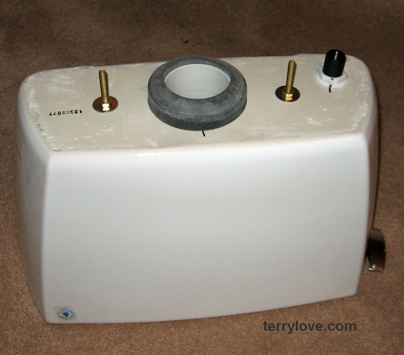

Q. If not, the leak could be from under the tank.
A. Where under the tank could the source of the leak be other than through a gap I have inadvertently left between the horn and the Fluidmaster?

Thru the bolts that hold the tank in place would be one prime suspect. This picture is from https://terrylove.com/forums/index.php?threads/loose-tank-bolts-big-mess.41714/ . Look through that thread.
Your test would be to close the stop valve at the wall to prevent the tank from refilling. Carefully note the level of the water, and put the lid back. A time later, such as 24 hours, check to see if the water in the tank has dropped more than a tiny amount.
If you reassembled the toilet, you might have under-tightened. Usually the porcelain is tightened so that three places almost touch at the same time. If they actually touch at the same time there is no further give, and the porcelain could crack. A standard business card can be used to gauge if they are close enough as you press the tank to increase the gap. If you cannot get a business card through stop tightening. If there is room for two business cards for one of the contact point when you deflect the tank, tighten more.
You can also try sticking paper or paper towel between the tank and bowl. If the paper gets wet at all, that shows the source of the water.
