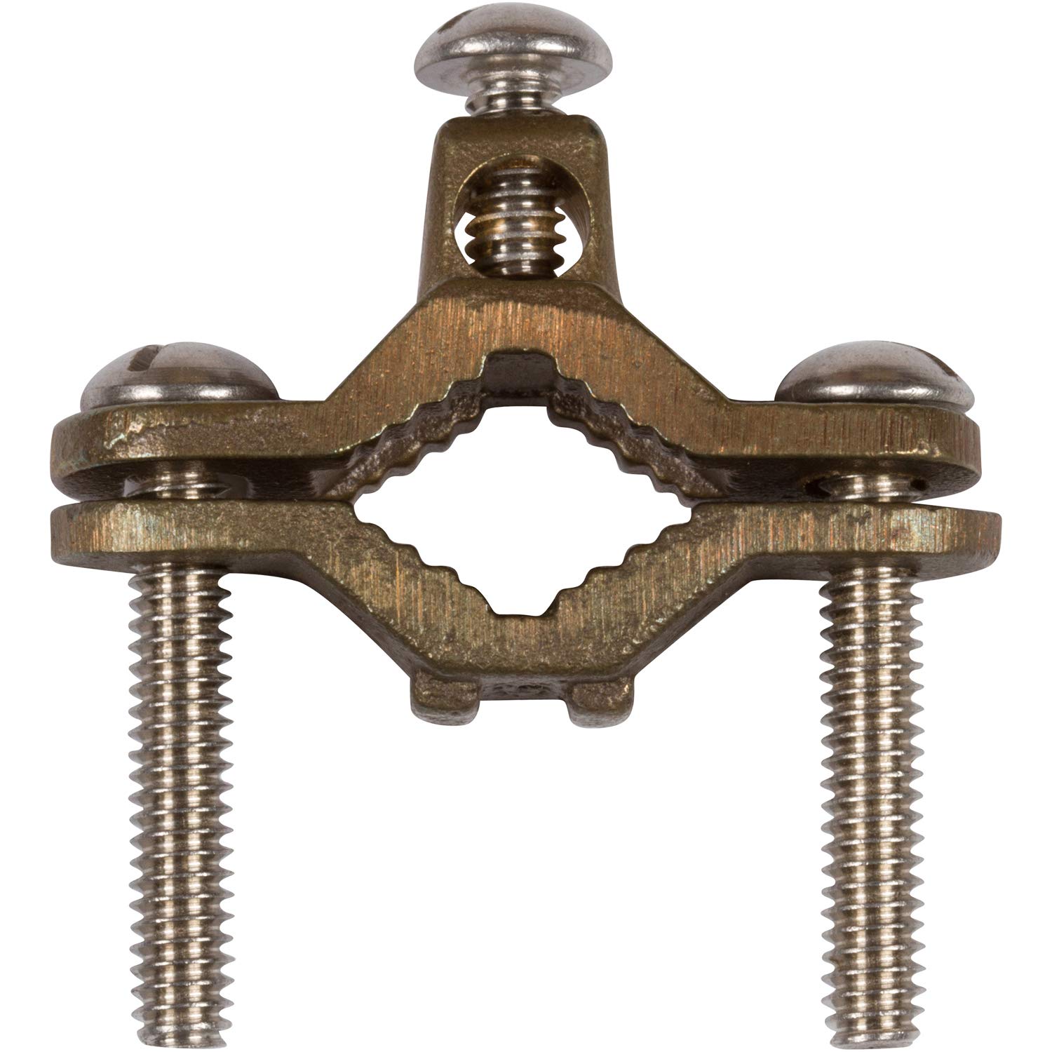

To address the OP's question, 2- 90° PEX fittings (1 hot - 1 cold) to supply a shower valve, is not likely going to cause much if any noticable flow restriction. The flow rate to a shower head will be typically 2.5 GPM max which even one 1/2" PEX elbow should have no issue passing.
While I anticipate the ground path to earth is currently obtained through the cold piping, that can't be assured and so the ground path maybe presently obtained through the hot piping.
To reestablish the electrical grounding bond between both the hot and cold supply pipes, obtain 2 electrical ground bonding clamps for pipe, 1 per pipe so as to jumper a length of grounding wire from one metal pipe to the other. Suggest using a thickest grounding conductor that will fit into each bonding clamp.
Is there currently a bonding clamp and ground wire that is bonding the metal plumbing pipes to the home's electrical service panel ground bar?
1. 1. I don't know if ground wire from metal pipe is bonding to the home's electrical service panel ground bar. I do know that when it was upgraded from fuse box to panel - a thick copper wire with clamp you showed in pic was attached to metal ground bar from panel. - how do check if this metal piping ground wire is connected to ground bar ?
2. Yes grounding wire is currently connected cold line - I guess you are suggesting that its not reliable so we should connect to hot water pipe?
3. Interesting there is a clam attached to hot water pipe that is connected to water heater hot line - so may be it serves the purpose that you are trying to achieve?
4. If I use PEX on top of these cold/hot supply lines - I guess it will break the ground path from where I make transition correct? so basically shower head faucet handle or tub spout will not have ground?
1,193
Again, don't confuse bonding things to ground and a system ground. Ideally, your electrical system is grounded. To pass any current codes, it would be. Older homes may have used the incoming water pipes as their electrical ground, but often wired everything with an ungrounded cable. That often isn't allowed today, but may be in some places. But, because the pipes contain water, and go lots of places in the home, and COULD come in contact with a faulty electrical wire, and, they could become energized during a lightning storm, it's good to bond them to the system ground for additional safety. The hassle for relying on them for a ground elsewhere in the dwelling is that they may not be continuous, with some PEX, CPVC, or who knows what in between sections. Utilities may replace their supply lines with plastic pipe. When ground rods are specified, you generally need at least two, and in some soil conditions, you may need more or a different grounding system. Getting a good ground in a dry desert location can be really tough. When I was at Ft. Bliss in El Paso, TX, when the communications people went out on a field exercise to the desert, they'd have their cooks order lots of salt. When they were setting up an antenna and it needed a ground plane, they'd mix up a vat of salt water, and soak the ground, otherwise, their antennae had lousy range because there was no good ground.
