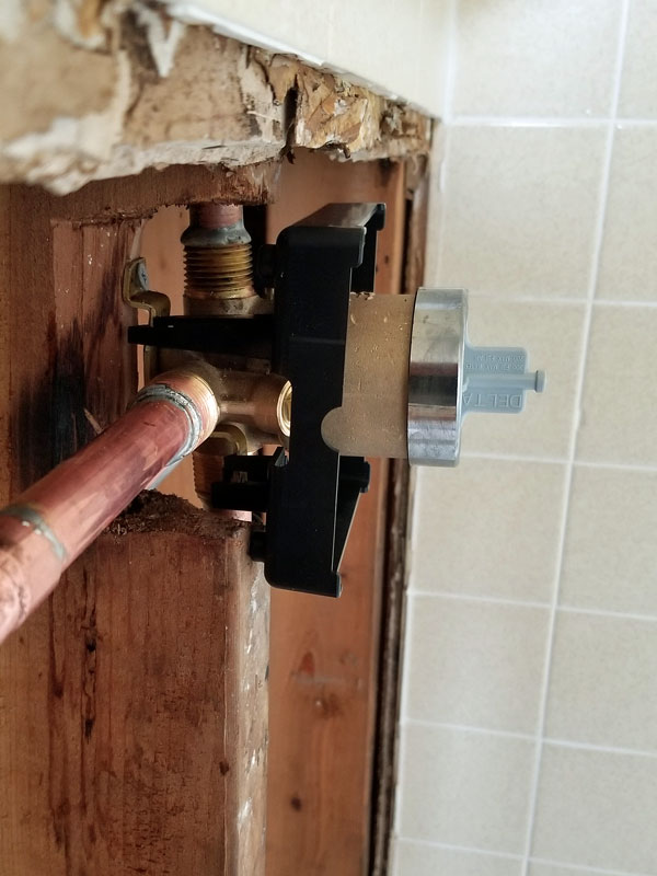

This one actually had stops with it. Moen 2600 shower valve. Moen was original to Seattle in the 40's.
The tile was falling off the wall here. If the tile was being worked on, it was also a good time for a new valve.

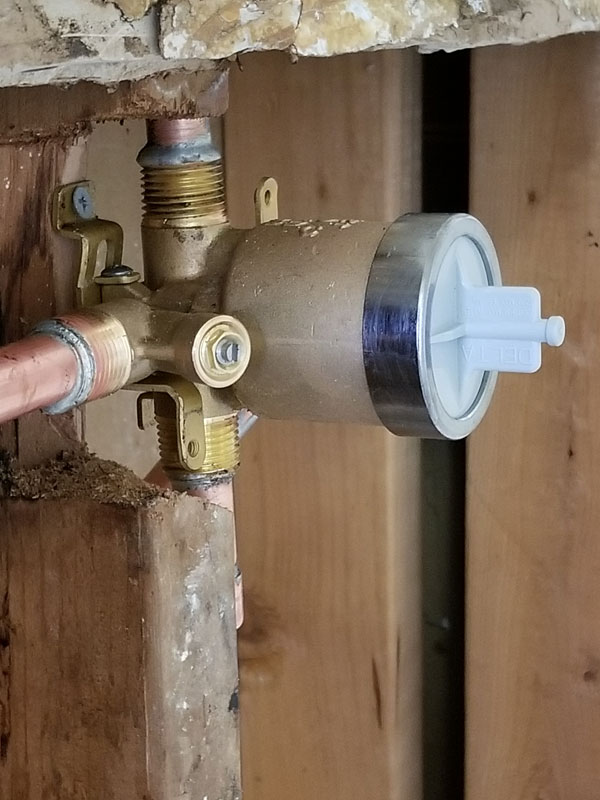

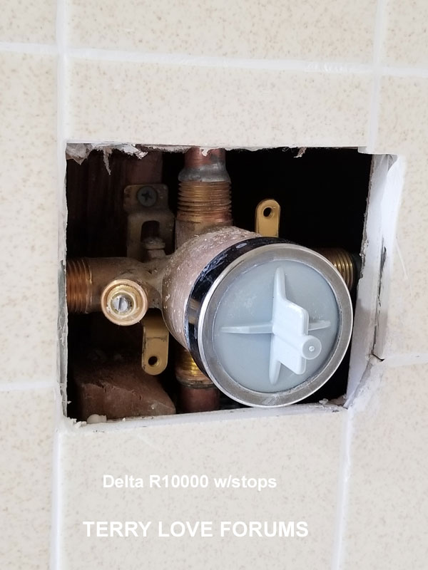

A new Delta R10000 with stops. Nice for a remodel because without them, the water crosses over. There is a plug you can get that blocks a port to stop that. The stops are nice though. I don't have to turn the water off to the home when I come back for trimming the valve.
Tile guard in place so I can access the stops later and screw on the wall plate.

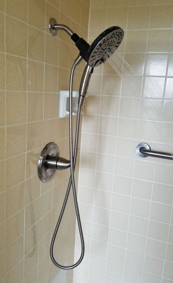

A nice job on the tile by TnT Grout & Tile Restorations
