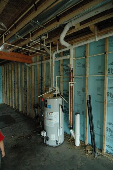

Dana, do those copper heat collectors actually work>>>?? It makes me wonder how long it will take to acutally
re-coup the money spent for the part and installation... Has anyone ever actually figured this out yet...?
why dont you get out your fancy calculater ---plug in the delta phi and break them numbers down for me ? Like 20 years before you have the break even point??
as far as water heaters go I got one here that probably could take on a 6 headed shower unit...
65,000 btu direct vented 50 gallon for heating and hot water..... do you think it would keep up??.....

Many people have run those numbers- this stuff has been around for over 30 years.
Yes, they definitely work, with sub-decade payback for showering families (even in low utility cost locations), as confirmed by multiple independent studies in the US and Canada and elsewhere.
In high energy cost states like Connecticut (gas costs about 2x what it does there than in the midwest, electricity more than 1.5x) it's a no brainer if you're using a 6-spray shower daily, independently of the size & type of water heater.
At CT's ~40F wintertime incoming water temperatures a 2gpm (that's low-flow) 105F shower is drawing heat at ~65,000 BTU/hr. (It's not hard math 2 gpm x 8.34lbs per gallon x 60 minutes per hour x 65F temperature rise= 65,052/hr). An 80% combustion efficiency 65K burner is only delivering 52,000 BTU/hr to the water. So no, a "...65,000 btu direct vented 50 gallon..." will definitely NOT "...keep up..." even with a standard low-flow shower forever, let alone a 6 head shower.
La aritmetica non e opinione. For a 6 head shower fuggedaboudit. A burner that's only ~1.5x bigger than a standard burner barely moves the needle on showering time for gusher-showers- it's all about the stored volume.
But with drainwater heat recovery at 50% heat recovery even a standard burner 50 gallon unit keeps up with the 2gpm shower, and offers significant "apparent capacity" for high flow.
OK, so let's bump up the flow. At 6 gpm it's drawing three times as much heat, or 195,000 BTU/hr down the drain. At 50% heat recovery it's returning 97,000 BTU/hr back to the incoming water, which is nearly twice as much as the 65K/80% burner is putting in, and about 3x as much as a standard burner would be delivering, and about 5x as much as the heat rate difference between a 40K burner and a 65K burner.
