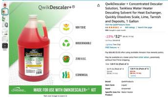

You got a recirculating pump for the descaling? What descaling solution did you use?
I pumped this solution through for 90 mins. 5 to 1 mix. So not the entire gallon. I have Vinegar to use on the next round.

It's stayed red, for the entire 90 min process, however, it got darker red from what was coming out. Like redish dirty water. I observed no yellow color change,
Do you have a water softener? That would minimize liming up. City water that comes from a river also tends to be less hard that water that comes from wells.

You have to have a water softener with a tankless heater or you will be pulling your hair out
deliming that thing twice yearly depending on the hardness of your water
