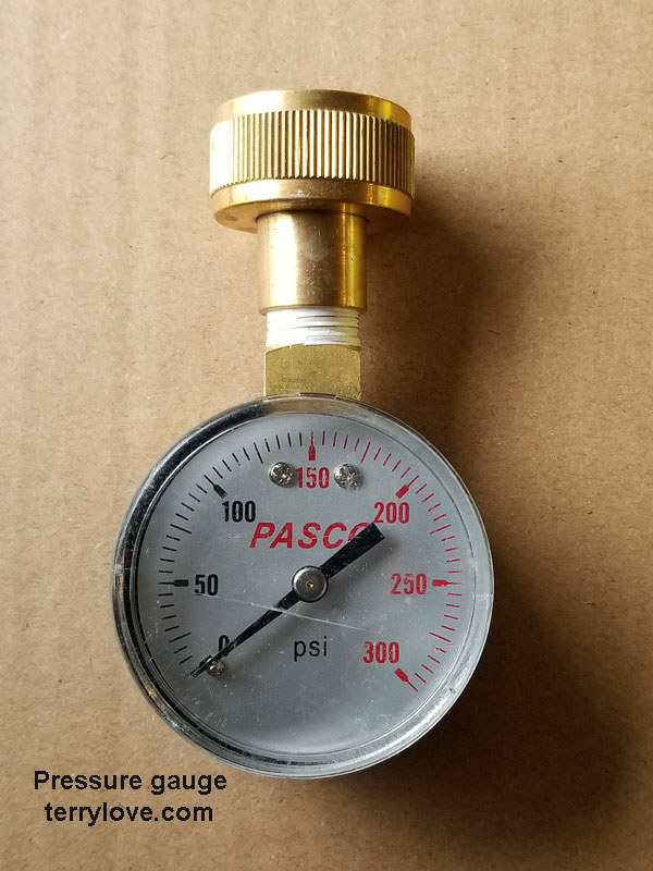

Off topic, but the type of NH coupling shown in the picture is lousy. Note the buckling.
