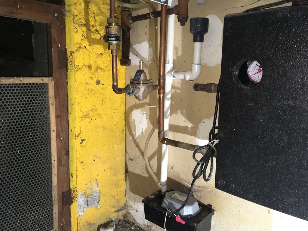

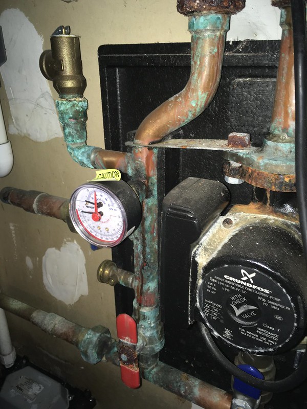

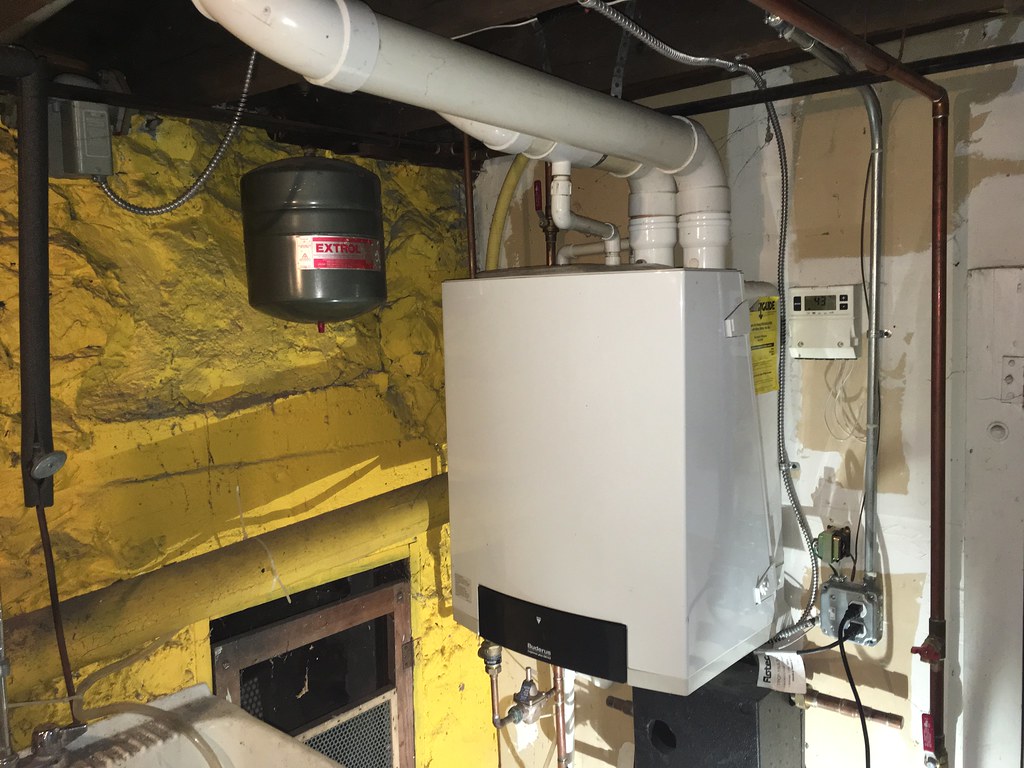

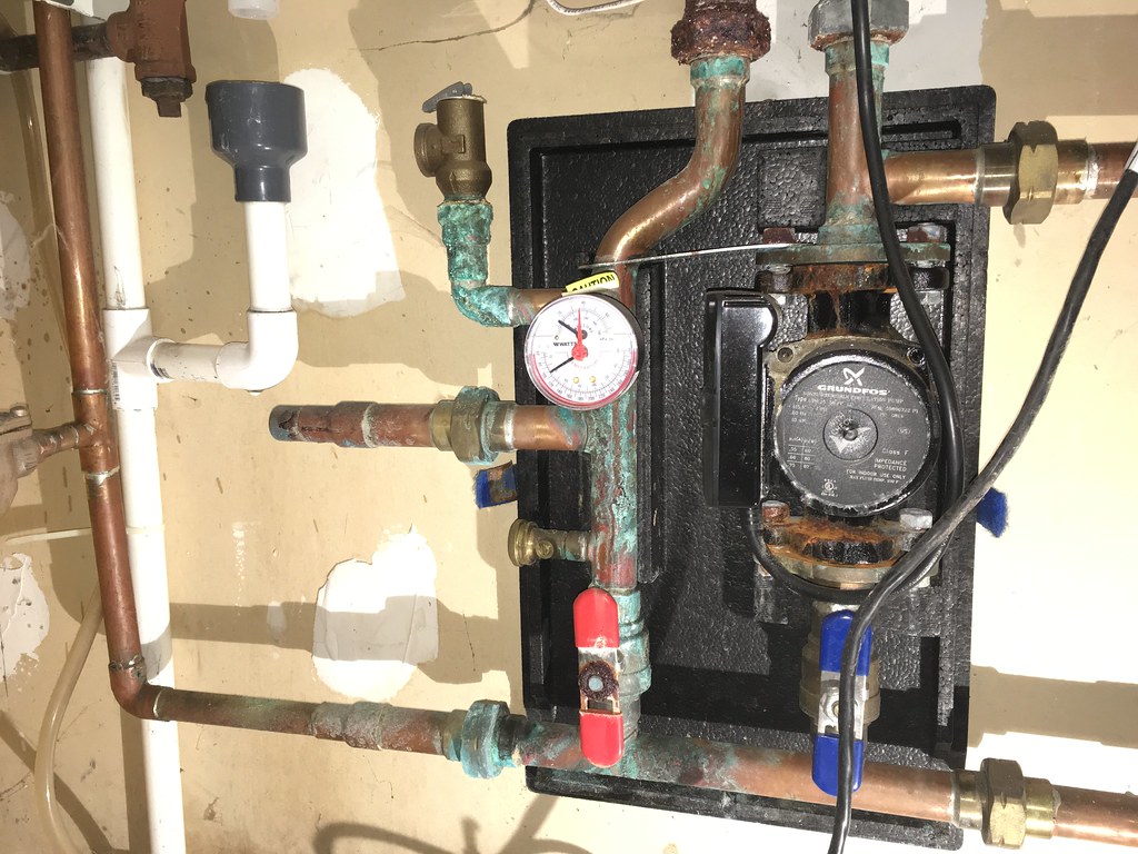

I just went downstairs and took some pictures of the whole system, in case that helps to figure this out. Below the boiler is a styrofoam box, where the circulator pump and pressure/temperature gauges are located. To be honest, I had forgotten the pressure/temp gauges were there, and never checked them against the value reported by the Buderus control panel. If this happens again, I'll check them both to see if they corroborate.
Also, there's a fair bit of corrosion on the pipes in there. I'm not sure what that's all about, but I imagine it's not good. My guess is that the condensate drain from the system, which ends above the black funnel that the condensate fluid drops into, has been splashing onto the pipes. I've seen it splash onto the foam box, but not the pipes, and have meant to extend it by another couple inches to prevent this from happening. But now I'm wondering if just enough of that slightly acidic condensate was splashing onto the exposed pipe and dripping down. Because it looks ugly.
Let me know what you think. I suspect this is going to cost a bit to fix...
Full System:
Backflow Preventer, Pressure Valve, Condensate pump:
Corrosion inside the foam box:

Also - on that corrosion, can I just brush that with some baking soda and water to try to neutralize it, or do I need to be thinking about getting all of this replaced?

I went downstairs and tapped on the expansion tank, which seemed to be empty on the bottom half, but full on the top half. Roughly around the seam across the middle of the tank is where the sound changed, when tapping.
Cycled the power on the boiler and within 30 seconds it was reporting pressure of 15PSI, and pumping out heat.
If there is water up top but not on the bottom, that says that expansion tank has not failed.
When your water pressure is minimum, that tank should be empty of water. So I would think the precharge (measured with zero water pressure) should be at least 4 PSI. Maybe it should be higher; I don't know.. As water expands with temperature, there should be maximum available room for the water to expand into. Is there an automatic refill in this system?

The ET precharge pressure should be your system normal working pressure. That boiler will not work if it is at 4psi. I'd have to verify, but I think the low-pressure cutout switch on that boiler opens up at less than 6psi, and 12psi is more of a normal range. The safety valve, unless changed because you have to pump multiple stories, is probably a 30psi version. If your ET has failed or not setup properly, that could be opening.
You could try a little bit of baking soda mixed with water...the corrosion may not effervesce as, if it is caused by leaks from the condensate system, the acid may be neutralized in the process of creating the corrosion. You could just clean it off. If the pipes aren't pitted, it should be fine. If it dripped on any electrical bits, the resulting corrosion is more likely to be a source of problems.

Another update. Yesterday we woke up to a cold house: 5 degrees below where we normally keep it at night. Went downstairs and checked the pressure gauge on the boiler control panel as well as the dial gauge on the hot water output from the boiler. Both matched: about 4PSI.
I saw a little water on the floor (not much, just a few drops), so I took the foam cover off the section below the boiler where those corroded pipes are, and found that there was a very small amount of water pooled below a cross-brace that connects the hot and cold lines. See below. There doesn't seem to be any water above that. when I felt it it was totally dry.
Power cycle returned pressure to normal, heat was back on in a matter of seconds.
At this point I'm starting to think that the problem might be in these corroded pipes - and this is a bit more soldering than I'm comfortable with, so I'm guessing it's time to call a plumber to come redo this section of the system? ugh. this isn't going to be cheap...
1,193
What I'd try is first to remove those threaded devices where you can, clean things up, get a quality pipe dope, and reinstall. IT really looks to me that things are leaking at the threaded joints - just look at the pressure relief valve and the pipe below it. Unless the pipe is severely pitted, it's only cosmetic, but if it continued onto any electrical connection or (an interlock, or sensor), you'd need to clean up the contacts and maybe replace the sensor(s).
Does the mechanical gauge move when you tap on it? They sometimes get sticky and do not read properly. Depending on the type of pressure sensor that is used for low-pressure cutout, that may be suspect or the contacts to it. If there is a buildup of debris to the inlet of the pressure sensor, it may not reliably read a correct value.
As a backup check, you could buy a screw-on pressure gauge and connect it to one of the drain valves to double-check the built-in one after you open that valve. Water nor corrosion do not help electrical connections or electronics.
FWIW, an ET that is actually leaking is way past failing...the bladder goes first (almost always), then getting water where it shouldn't, if left long enough, will then start to cause it to rust out from the inside. But, you'd normally notice problems as soon as the bladder fails...rusting out could take quite awhile after that has occurred.

When I got home today and went downstairs to reset the boiler, I noticed that there was some water pooled on the pump seen in that picture as well (that's on the return side of the loop). So I'll be doing both of those threaded connections, just to be sure. Far as I can tell there's nothing on the electrics for the pump, so that's good.

So yesterday I drained the whole system, cleaned the threaded fittings and as much of the corrosion on the pipes as I could (with a wire brush, mostly), and attempted to loosen the large nuts on the output and return sides of the boiler. No luck moving them. Tried tapping them, applying heat, liquid wrench, but none of it worked. So I filled it back up, purged it, and powered it on. I did see some dribbling out of both of the large threaded fittings, so I'm pretty convinced this is the culprit. I'm probably going to have to have someone come in here to deal with this, because it just wasn't happening for me.
On the pressure question: the mechanical gauge and the Buderus control panel are always the same. So I think the issue is a slow leak causing the cold pressure to drop below the boiler's cutoff threshold.
Below the boiler, on the return side, is a circulator pump. When you power on the boiler, as long as there's sufficient pressure, this pump is always running. On the output side, past the expansion tank, is a Taco circulator pump. When I was testing this yesterday, I couldn't tell if it was running or not. I never really paid much attention to how loud it normally is, but I couldn't really hear anything from it. My understanding is that the pump below the boiler is not supposed to cycle the water through the whole system, so if the Taco pump is dead, could that also lead to pressure issues?
