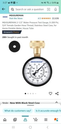

I bought a water pressure gauge and I assume I need to attach it to where you drain the boiler (red knob close to the floor) and then turn on the water. My boiler is set to 12 psi so I assume if the water pressure gauge reads higher then my psi gauge is off and I need to drain some water out of the boiler until the water pressure gauge reads 12 psi
