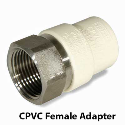

I've never had a problem using tape on CPVC threads. You don't want to thread into a plastic (CPVC or PVC) fitting though. I prefer the plastic male adapter to thread to a female fitting. They do make a stainless reinforced CPVC fitting though which works well.

Thanx. I'm new at the game- at least with PVC.
(heh- ask me about computers sometime. Fifty+ years as a techie -everything from S360/370 to Raspberries)
Your 2nd pic above is confusing. -
a ¾" CPVC male adapter? Looks like a male brass thread into a female CPVC.
Anyhow, I'm gonna fit my male adapters onto the brass ball valve with some Oatey white dope,
and then glue the slip-on ends to the original CPVC pipe. And hope it doesn't leak.
If it does? Well, simply saw off another inch of the old CPVC, and try again. Maybe with Teflon tape. I think I can do this at least 10-15 times before I run out of pipe. ;)-)
