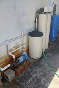

Thanks Valveman. Sending pictures of the wellhead and the pump set up (same at both houses).Resized_20250128_114442_33795764679398.jpg20250128_114251.jpg In south Florida we hit a great water table at 80 ft.+ and use shallow well pumps / iron and sulpher filters / salt for softner. I appreciate your wisdom about the check valves and will put it to the test !

The well maybe 80' deep but the water level is less than about 20' for that set up to work. With filters and softeners I usually start with a 50/70 pressure switch and a constant 60 PSI to make up for friction losses. Looks like a J15S pump? If so, and the water is shallow it will work with a 50/70 switch.

These are old mobile homes. Not sure the plumbing can take that pressure. Has good pressure now. The pressure tanks are large and inside house pressure differential is very slight. Has been acceptable for 15 years. Not a constant pressure setup.
