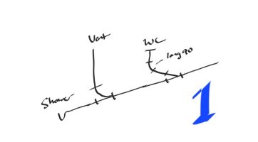

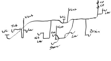

Aav's aren't legal in the upc. But vents can be run flat after they are above the trap. There's no reason to route it across the house if it can run inside of the nearest wall up through the roof. Your drawing I think it's getting worse.
Jeff H Young
9,803
2,481
92346
would this work?
that would work but I think it might be prohibited as no fixtures can drain from upstream of the Island vent?
The choice to run an AAV , I just saw a you tube video telling which states are legal a whole bunch came up but MN came up as specificaly illegal but Ill let you verify, it would be fine most places
How about a cleanout at the end of the 3 inch just past the laundry room withen 5 ft of end ? Or a 2 way out front where it exits house if inspections are a thing there Im only nit picking to get you throu passing code

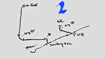

can vent 2 work? or does it must be vent 1?
vent 2 flat line does have 1/4 inch per 1 ft slope.

Must be like vent 1
Is there a reason why? I mean number 2 is just pretty much re positioning majority of the vertical pipe leaving roughly 6 inches of vertical at the connection of the shower pipe.

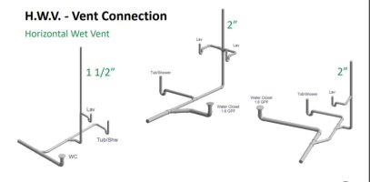

Also I am just trying to understand why based on researching online, I see drawings like number 2 but is called hortizonal wet vent, even though number 2 doesn't have a fixture connected to it?

Horizontal wet vent has a fixture draining into it if it dosent have a fixture draining into it it becomes a dry vent and a Dry vent must rise verticaly (or at an angle of 45 degrees minimum ) until at least 6 inches above the flood level of fixture so on a sink generaly we just say 42 inches above floor befor breaking horizontal.
The reason is because if the fixture backs up whatever crap is in there will get into the vent system rendering the vent useless possibly. on a wet vent the vent below will be washed clean by the drainage look at those images you posted the vent underground can plug up but you would clear it or the Lav wont drain
