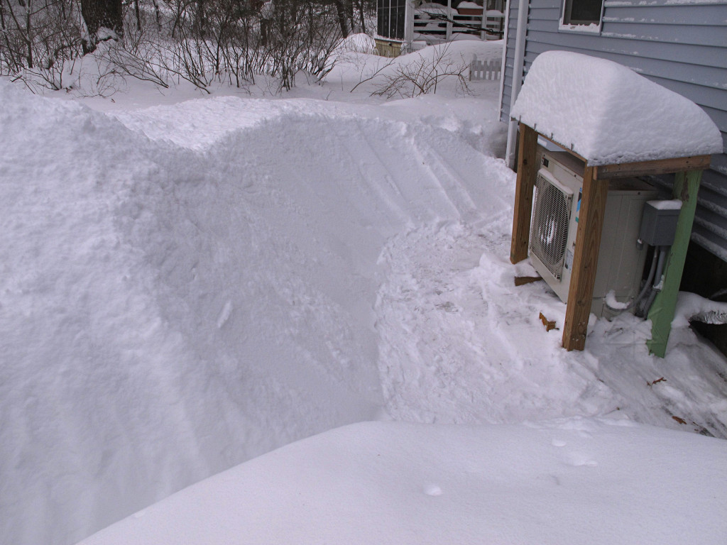

Even when it's installed by the book, the book doesn't necessarily factor in niceties such as installing the compressor well above the historical maximum snowpack depth so you don't have to dig it up after every winter storm. A common flaw I see in New England is that they treat it as if it were an air conditioner that would never need to work in a snowstorm, sometimes even mounted in the drip-line of the roof to guarantee that it experiences extreme icing-up or gets destroyed by a falling icicle or roof avalanche.
These were installed by licensed professionals too:

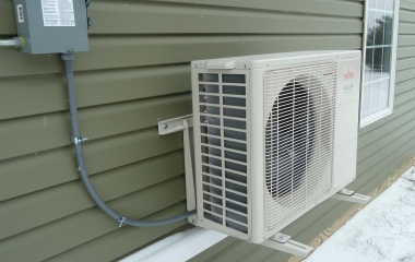

Bracket mounting it on the wall, above the snow-drift line also keeps it from sucking in weeds that might otherwise be growing around it too:

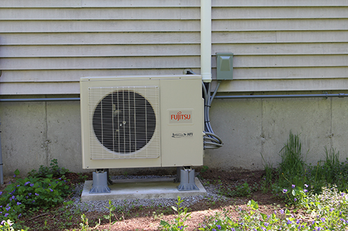

This one is probably a bit too close to the porch, but the elevation above grade and the weed-control around it is pretty decent:

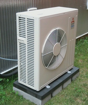

This one is susceptible to weed growth behind it, and sucking in leaves with nothing to control vegetation, but at least the pad is somewhat elevated, and it's on riser blocks:
This one is somewhat better, but should be a bit more level:

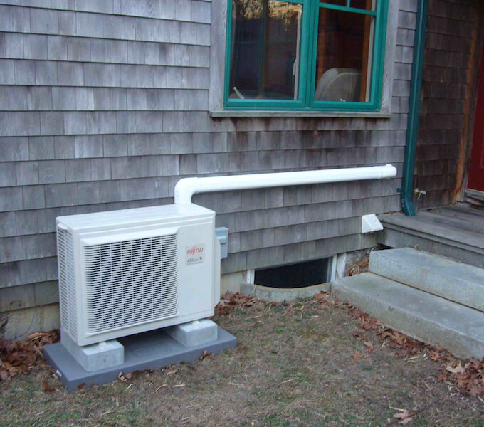

This one is guaranteed to suck in grass & weeds, with no weed perimeter:
These should remain pretty clear & clean without a lot of maintenance:
Purpose-made wall mounting brackets are not very expensive, and makes keeping the coils free of crud a bit easier. Landcaping fabric & washed gravel under this unit probably would be better than the bark mulch under this bracket-mount, but at least you can weed the mulch easily:
