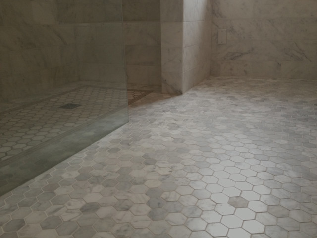

Noble Company is the way to go.
This shower started out with a Noble Company Square Drain (actually made by Sioux Chief) and a Noble Flex Flashing.
This was a large renovation involving a structural engineer, city planning committee, city hall, preservation society..... yatta yatta yatta.
I think I did a pretty dam good job prepping the shower for tile. I love this bathroom!
All Marble Tile. The entire shower and bathroom is a wet room. Water drains from every point outside the shower to the shower entry. From there to the drain.
Needed to get some 14' LVL's in there and even with that could only cut them to 8". Tough build - but turned out great.
Soak test those small tiles. The mesh backing often is water based!! You do not want this.
Check a large sampling of tile when you soak test. DO NOT SKIP THIS STEP

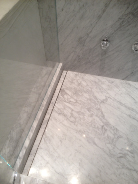

John,
that first bathroom is really impressive. I have to say that the marble tiles on the wall look very good, and maybe I should stick with that as my original plan. I think I will still need to make sure that the contractor uses the right materials to adhere the tile to the walls and the flooring is well protected. I hope that Noble is able to help with these selections.
What you did with the glass coming off of the floor like that is how I envisioned my other fall project for our condo. It is small shower living, and I liked the idea of using glass to separate the shower area. My worry is that most contractors could not execute a job like that. Maybe I'm being cynical

John,
The first bathroom is not Marble Tile but Marble slab like you wanted in the first place. There is a giant hole somewhere in Italy after renovating that bathroom. Slab on the floor, walls, ceiling, tub deck on and on......
