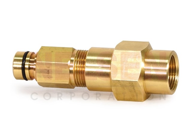

I purchased this:
Which is the fleck 2510 brass dlfc that allows you to go to something like 15gpm (I bought the 10 gpm one).
I believe which I could be wrong, that it has a much wider hole in the quick connect portion and I can probably change out the flow rate with the 9 gpm dlfc that I just bought with the 10 gpm if I want. I'll try both and see which gives better results.
I'll update when I receive the new part. In the mean time I am backwashing every day and based on the filter between the softener and the katalox filter I am not getting much Iron passed. And the filter after the softener has not changed (5 micron) whatsoever so any iron residual is getting resolved by the softener.
I'm getting close, hopefully I close it out with this final part. Again I will update when I get there.

Final update, hopefully the iron will be fully filtered out by this but thought I would throw this out there (I may add .5 cu/ft of media later).
I bought this like I said:
Installed it, getting between 8.5GPM - 10.5GPM depending on when pump is on/off (it drops to about 8.5GPM right before it kicks on).
Bottom line is baseline.
Middle line is the plastic DLFC with no button and 1/2" outlet drain line (3-4in)
Top line is with the Brass DLFC with 10GPM button and 3/4" outlet drain line (6in)
Based on calculations you are giving which are probably right:
22in of media:
18% lift with the 1/2" (8 GPM)
27% lift with the 3/4" (10 GPM)
Still seems a bit low, IMO but it is much improved, I might grab a 12 GPM DLFC and see what happens but I'm not sure I will need to.
If it does not work I will end up rebedding the whole tank this summer with new, but I'm going to do some water tests in a bit after getting this installed and letting it do it's stuff for awhile.
Thanks for the help again, didn't want to leave this unanswered.
