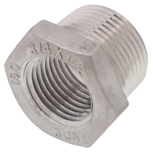

I was under the impression that the softener had a 1/2 NPT thread and you could use something like this https://www.surpluscenter.com/Hydra...e-Straight-5404-12-08-Adapter-9-5404-12-8.axd
So I envisioned you would take the current DLFC washer out. Unscrew elbow shown as part 25 on pages 15,16.
I could be wrong.
Alternatively, put a 1/2 3/4 bushing
into the input of the 3/4 DLFC assembly and use a 1/2 inch brass or stainless nipple between the valve and the DLFC. Or mount the DLFC farther downstream rather than as a potential lever on the valve. https://www.supplyhouse.com/Merit-Brass-K414-1208-T304-3-4-X-1-2-Stainless-Steel-Hex-Bushing
Note that DLFCs are not symmetrical-- there is an in and an out.
I could be wrong.

There is a brass quick connect with a 3/4" threaded connection already but this looks like it would probably be cheaper solution it also may not be a huge issue with the limited 1/2" only being limiting for less than an inch.
