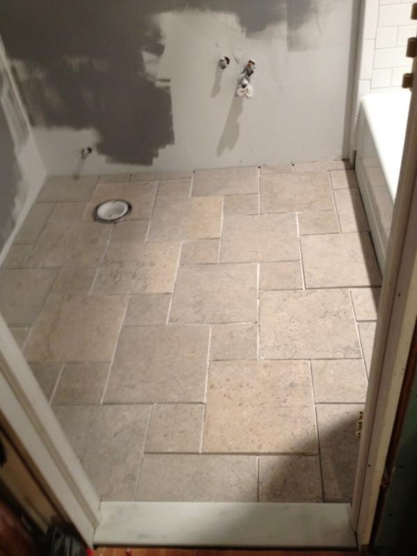

Hi Guys..
I'm tiling my floor and will soon be installing the toilet. American Standard Champion 4 (they got me on the hotdog flushing videos).
I have 12 3/4 inches from the wall to the center of the pipe, the toilet says 12" rough in.
In the picture below, the tiles around the edges of the room (including the one under the flange) are just sitting on the floor- no thinset yet. The flange is just stuck into the pipe for alignment purposes. Its one that fits inside a 4 inch pipe or onto a 3" pipe. I have a 4 inch pipe. I cut the pipe a little short.. but I have at least an inch for primer and glue..
So here are my questions:
1. Is there a better flange to use in this instance?
2. Once I glue the flange down.. the metal ring will spin around and need screws to hold it down.. Carbide pre-drill through the tile and then stainless screws into sub-floor?
3. How do I align the ring properly? What do I use as a reference? The walls aren't square like most houses aren't, and I have no vanity yet. should I just wing it? Do the slots for the closet bolts offer a lot of adjustment? How much could I be off and not have anyone notice?
The metal ring is fine. You can use the slots, that gives some adjustment later. Galv or stainless screws for the flange are fine. You align the bowl so it looks right to the eye.
Buy shims for installing your Champion. They tend to be a bit wavy on the bottom. That's why we install so many more TOTO bowls. You must be feeling lucky if you bought American Standard. I'm not a gambler. Good luck!

A few other thoughts:
(1) As Terry alluded to, his experience is that the American Standard products now are very hit or miss as to whether you'll get a defective one. There are lots of stories on here about it, but bottom line is that you should inspect your Champion very, very carefully, looking for things like areas that were not glazed, particularly in the bowl, chipped or broken areas that were repaired at the factory and yet sold as new, defective trapways, castings that slump to one side or another, etc. Please, please take it back as many times as you need to (more than once isn't unheard-of) in order to get a good one. If you do, it will do the job, as shown in Terry's Toilet Ratings (green box above). The point is, make sure YOU are happy with the one you get, and keep returning it until you are. If it seems defective, it is. And believe me, anyone who sells these things has seen it before, no matter how surprised they claim to be.
We're not kidding: apparently, AS will sell this stuff and just hope that the homeowner doesn't return it, and our experience on here (which is sometimes heartbreaking) is that they typically don't. That is, someone saves up and special-orders an expensive AS toilet in a particular color; it arrives with a big spot of glazing missing right in the bowl, which couldn't have been missed by even the laziest QA in the factory, but it isn't noticed by the homeowner until after they install it, and they're very sad because they were so happy to get their new toilet and instead have spent all this money on something defective. So they are sad, but it just seems like too much of a hassle to replace it. So they live with it. It appears to be an awful, cynical approach to doing business. It's like GM used to be -- all marketing and limited engineering or quality -- which is why the Japanese manufacturers, who focused on engineering and quality assurance, wiped the floor with them. It's happening again with toilets. Toto does almost no national retail advertising, and yet word of mouth, recommendations of professionals, and sites like this have let them explode in the American marketplace, basically on merit alone.
(2) 12 3/4 is going to give you the toilet's 1.25" plus another .75" off the wall. That 2" or so isn't small, so make sure you paint the wall first and well, because the area behind the toilet will be visible. The benefit is you can easily clean and dust behind it.
(3) You are doing it correctly to mount the flange on top of the tile, secured to the subfloor. That's what is going to hold it in place for the toilet to be secured to. One way to align it is to put the closet bolts in to the long slots, threads up, slide them all the way to the end of the slots, secure them with a nut so they stay there for now (and most plumbers do that when installing the toilet, too: two nuts -- one on the flange, one to secure the bowl). Now, use a long straight edge of any kind on the wall side of the bolts to get a sense of their alignment, and spin the flange until you have them aligned how you want to align them. It's typical to square the flange bolts to the rear wall -- after all, your other fixtures likely will be square to that wall -- but you can do it so it's how you like it. The slots give you some wiggle room to adjust the toilet so it looks good even after you have secured the flange to the floor. When you have the flange aligned how you want it, mark the drill holes, and drill your holes through the tile then secure with screws to the subfloor below. The toilet is going to be held to the floor by the flange, and the flange is going to be held down not by your glue, but by the secure attachment by screws to the subfloor.

I put the grout in last night.. and ordered wainscotting for the bottom 36" of wall.
When I do install the toilet.. can I use the wax rings and bolts that are in the toilet box, or should I get new ones?

I would look carefully at what they give you in the box, because it's not always the best quality. Frankly, if I were going to spend money on something, I would get myself a better set of tank-to-bowl hardware, as many of the reporting professional on here do with this toilet. I would likely get a decent set of closet bolts, meaning made out of an appropriate material in a good thickness, with two nuts: one to nut to the flange and another to secure toilet to flange. As to wax rings, if you have the flange at the proper level, which you will here, a standard-thickness wax ring should suffice; when using a single wax ring, many posters here recommend the one without any kind of plastic horn or flange built-in. Of course, it couldn't hurt to have a good, thick wax ring...
BobL43
DIY Senior Member
1,802
Long Island, NY
Just out of curiousity, why do you feel that the bolts and wax ring are any different than what you'd buy yourself? Are they not brass bolts, or long enough?
On my last toilet installation, I used the Sani-Seal ring instead of a wax ring. Its not very long ago, but it is very neat to use and I liked that part of it. I have had no leaks with it, and hope it lasts as long as the wax ring that was under the old toilet that I replaced. time will tell
