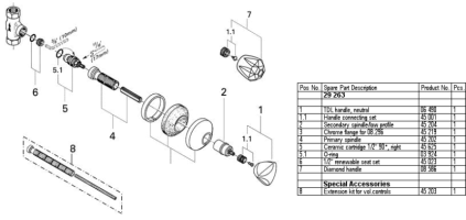

Thanks, Terry & Jeff. I was able to pull the knob off. It appears that the threads on the knob are sound and thus not causing the problem. The metal arm (onto which the knob sits) is not fixed, however - it can be pushed in or pulled out. This is the reason that we are having difficulty in getting the knob to correctly engage.
Is this a simple problem to fix? I am not an expert and don't want to take something on that could potentially create more of a mess.

How about a picture without the handle on it?

I never worked on that one or seen it but the handles are classic to the brand Is this a diverter ? id try unscrewing the tube then id try unscrewing the cartridge replace whats bad

I'm not to sure but maybe these are the parts you would have to replace?

I guess he got busy but Niel Binda looks like you've got picture of a diverter I think that's what he had
