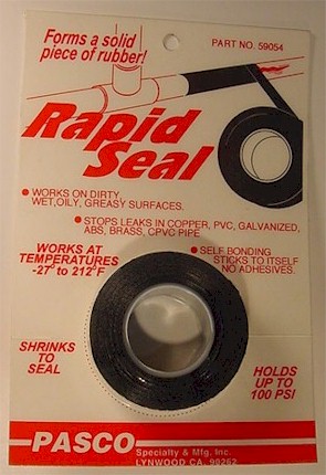

As a temporary fix, try this product. I'm curious how well it works. It should hold you until you get some bids by local plumbers.
I think Wal-Mart sells a version of it, as well.

They don't mind tearing them apart, but they will not fix them. That's why you will need a good handyman when you are done to clean up after them. :D

Surely you're joking?
Verdeboy
2,041
Which part?
Cleaning up after plumbers? or testing out that stuff on a PVC leak, while he's waiting for a plumber?
PS: It sure beats the Rube Goldberg contraption he was using with the foam and the hose, etc..

Using that tape!
