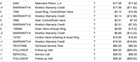

here are all details of all invoices..long but informative
2-17-22 was date of purchase. dug up all my receipts
3/14/22 order was: | Water Softener: Cycled Water Softener / Treated hardness level - Cold 0 / Treated hardness level - Hot 2 / Checked Brine Draw. Dechlorinator: Chlorine level after dechlor 0. || Checked all the functions of the water softener and everything seems good. Unit is metering perfectly. Unit is drawing a good brine in backwashing great. Salt seemed a little bit hard in the tank and possibly was bridge but not much. We will return in about three weeks to do another follow up just to make sure everything is good
3-28 replaced bunch of stuff
Service: || Water Softener: Cycled Water Softener / Treated hardness level -
Cold 0 / Treated hardness level - Hot 0 / Checked Brine Draw / Lubricated
All Seals / Replaced Softener Valve Parts / Unit was giving salty water.
Salt settings were all good. Checked unit thoroughly inside head and found
no debris
9/1/22 Customer brought water in to be tested for hardness. Water was hot and it tested with 13-14 grains of hardness. We installed it back Feb and it seems to be a continual issue then they came out and said Cold water soft. Hot water 3 gr hard. Cleaned mush from top of grate . Checked salt setting and brine draw. All good.
found november invoice from dealer:
Trouble: Stop out and diagnose issue. Water tested 9 grains hard at the shop
from the hot side. We have been out multiple times on the same issue.
Service: || Water Softener: Cycled Water Softener / Treated Hardness Level -
Cold 2 / Treated Hardness Level - Hot 7 / Raw water was 21 gpg. Unit was
running out of capacity. Changed to a disc 4. Salt tank had a little mush
under the grid plate. Cleaned out salt tank
