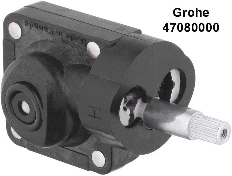

My contractor installed the Grohe Europlus II 19 716 000 shower/tub valve 15 years ago and it's leaking so I'm trying to replace the cartridge. I removed the hidden allen screw and tried pulling, tapping it in first, prying (gently) with a screwdriver all to no avail.
How do I remove that handle without breaking anything?
19.716 Europlus II Trim (that's the difficult handle)
35.253 Rough-in-valve (that the handle is attached to, brass on the outside but plastic cartridge on the inside)
Pictures below.

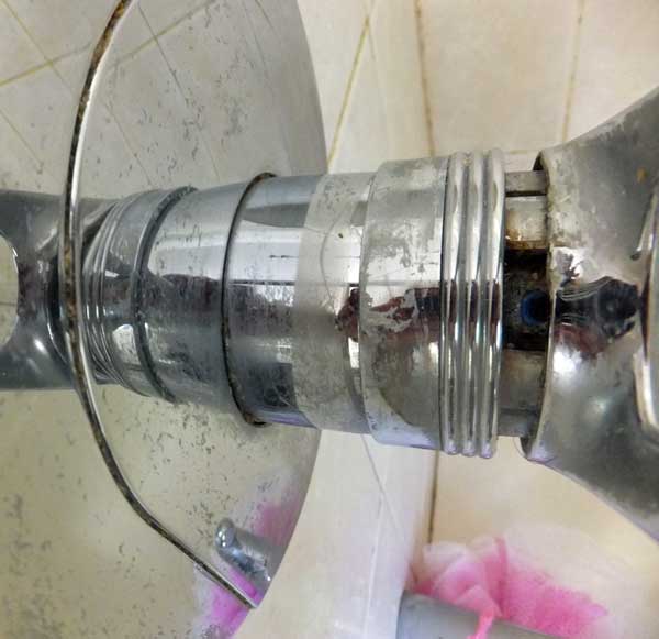

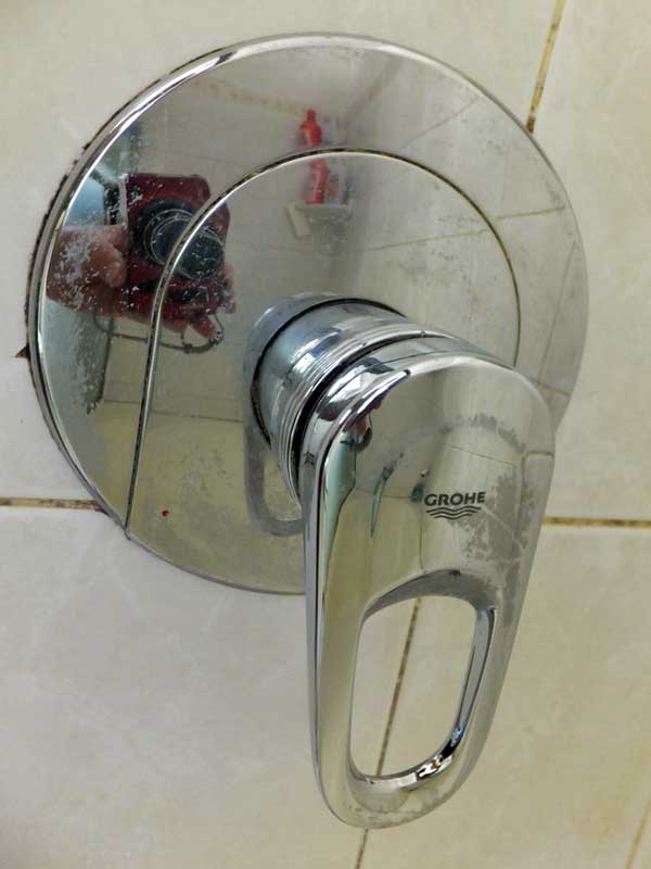

I have this same shower faucet. I was able to remove the set screw but still can't get the handle to come off. Is there anything else I need to remove or do to get the handle off? Thanks!

I have what looks to be the same unit, but my handle absolutely does not have a set screw. We installed the same style faucets for our sinks and for a shower and a tub and shower. The sinks faucets definitely have the set screw. The tub and shower do not. The big difference I think is that the tub and shower just rotate from cold to hot, there is no way to set pressure since the handle doesn't tilt. As far as I can tell, the handle looks to be 'pushed on' somehow and I can't figure out how to get it off. I'm looking for
any ideas. I removed the inner cover thinking I could finally get to the set screw, but there is no set screw. Here is what I'm looking at:
