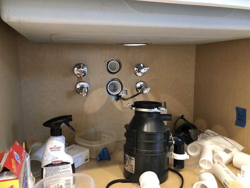

Hi there,
This is my first post here and I'm hopping someone can help me figure this out (I'm loosing sleep over it for 3 days already :confused: )
I replaced my sink as part of a kitchen remodel.
I Went from a shallow double bowl sink to a single bowl 10 inches deep.
To make matters worse, instead of being in the center, the basket is placed towards the back of the sink.
Why I did that? Simple: the guy at the store (selling the cabinets) told me to just "choose a sink" so why not get the nicest one? :mad:
Anyway, now I'm faced with 2 problems:
1- Garbage disposal is too close to drain line so it cannot come out of the wall straight.
2- Garbage disposal is "almost too low".
I came out with a few solutions that you can see in the picture.
Nothing is glued or installed in there, even garbage disposal is just hanging so it may go up 1/4 " after properly installed.
These are the things that are bothering me:
1) As far as height goes, if you consider gravity I don't think it is going to be a problem, is it?
The bottom of the disposal outlet is a little bit higher than the bottom of the drain pipe so... should I be concerned it won't drain?
2) Is it ok to add a 2" to 1-1/2" reducer right there in the wall (where there is a tee) or do I have to come out with 2" and somehow reduce it after the cleanout, as it was before when there was plenty of space?
3) The drain line cannot come straight from the wall. Is that curve ok (see pics)?
4) As for the ptrap, as you can see in the pics, the only way I can make it work is by bringing it down about one inch. I know this is not how it is intended to work be but will it cause me any problems?
5) Final question: do you see anything that could be considered a code violation?
Trying to consider my options before I have to call someone to start breaking things.
Thanks in advance.

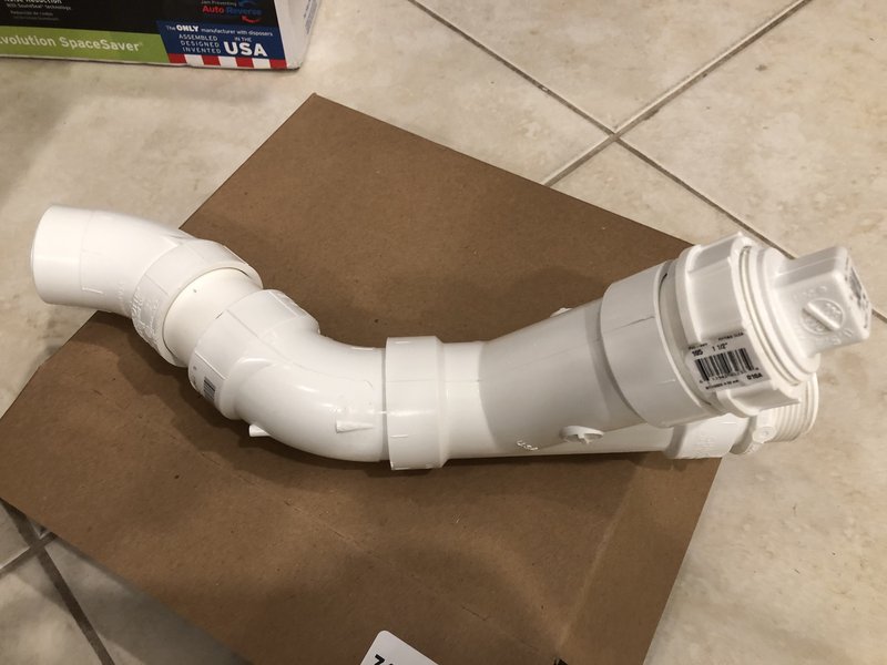

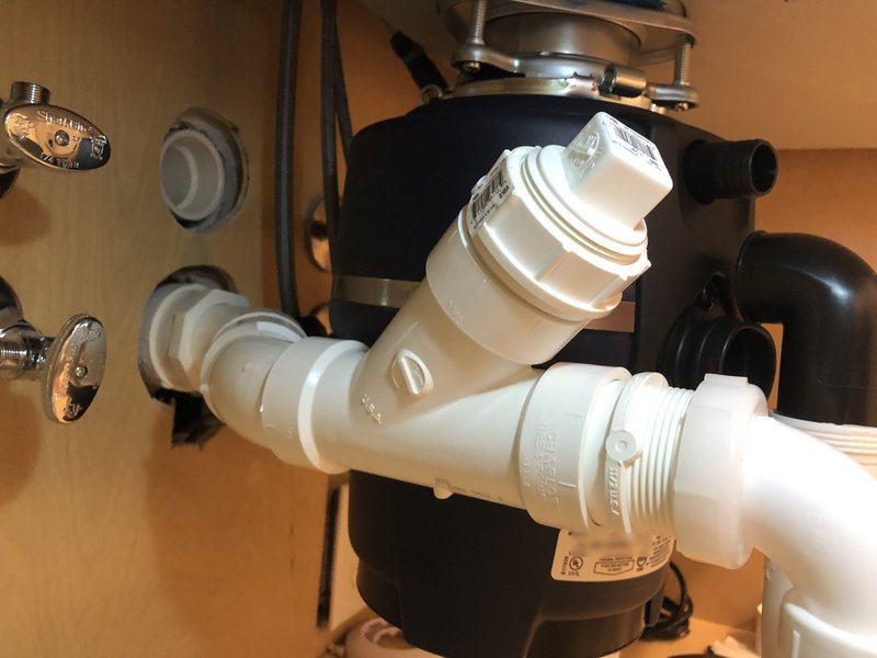

That is exactly kind of what I have going around the disposal (see last picture).
Two 45s against each other and a wye so I can have a cleanout plug. The wye is the biggest issue due to its size and I needed a small piece of pipe between the elbows to extend it just enough to go around. Doesn't look like I can get away without gluing the whole thing.

With a slip joint trap, you can remove the stuff back to the trap adapter, and rod thru the trap adapter.
In retrospect, you could have gotten a sink with an off-center drain.
Also, if you did have a wye for cleanout, the wye could be rotated some CCW if that improved clearances. But I don't think you will need the wye with the slip joint pipes.
If that lower left stop valve is in the way, maybe you could do something about that. Are those compression stops on copper stubs, or what?

Before going any further connect the disposer to the sink and tighten it so that it is in it's final position.
Now measure from the bottom of the cabinet to the centerline of the outlet of the disposer and measure from the bottom of the cabinet to the centerline of the drainage Tee that is coming through the back of the cabinet.
From what I can see on the pictures they both appear to be at the same level, if this is the case then your disposer will always be holding water and you will have nothing but problems in the future.
If you really love the sink and the disposer you may have to open the wall and lower the drain;
If you really love the sink but not the disposer then solution is simple.
If you don't love the sink enough to open the wall then you will need a more shallow sink.

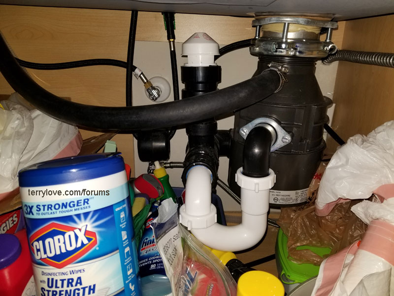

I saw this one on a new home. Not really planned out well.
A very deep sink, and the drain in the wall behind the disposer.
The 7/8" hose from the air-gap has a big loop in it.

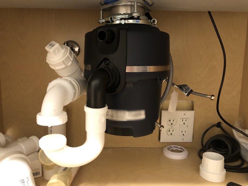

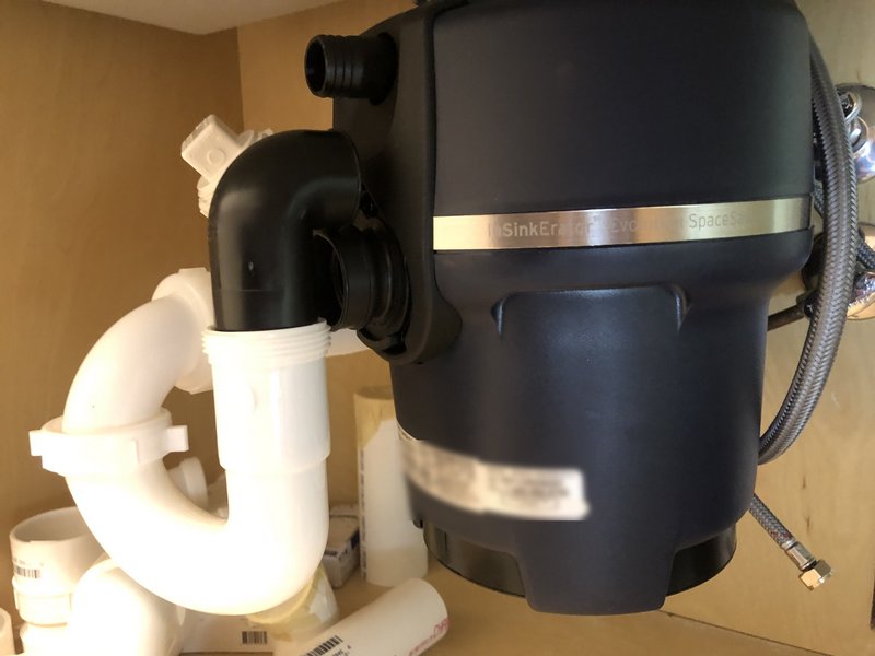

The disposal elbow pipe can be cut and inch or two and still have enough pipe for the slip nut to grab. If you mess up these are sold in stores.
Lowes shows this as store stock. Along with cutting the disposal pipe, and this short trap it might just work. Better than opening walls.
My home in Palm Beach County and here in Orange county, a cleanouts were never installed by the home builder. With slip joint p traps it is really not needed. If the sink is on an exterior wall, then you'll see a clean out on the outside wall. When I had my kitchen remodeled, I did the plumbing and got wise and lowered the wall connection, perhaps a little too low but using a simple tailpiece extension took care of it. My setup is identical to yours.
