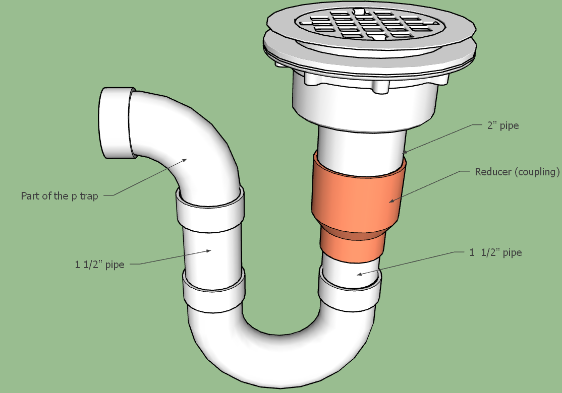

Do I need to install a reducer from 2 1/2" to 1 1/2" for this shower drain ?
Mini Me
357
12
Toronto
Who told you that?
I expect that is made to go into a 2 inch hub, and accept a 1.5 inch pipe. You have the equivalent of a 2 inch pipe coming down from the drain, right? So you would need a 2 inch coupling (two hubs)
plus the bushing
Then a short length of pipe into the trap.
From the videos I am seeing on youtube the bushing goes inside of the larger piper and the smaller pipe goes inside the bushing, both glued which I like more than using a rubber gasket It also seem to save room compared with the reducing coupler that is longer

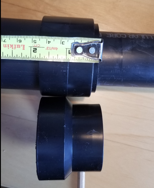

OK I went to the store and I bought the bushing and the coupler together with the shower drain
https://www.lowes.ca/product/shower-drains/2-in-dia-brass-shower-drain-w-ss-strainer-253154
After trying to dry test everything it turns out that I am like an 1" short to go with either a coupling OR or with a bushing
The bushing does not make any difference because it requires a coupling piece in order to get into the 2" pipe
Here is a picture
These being said I think I have two options:
-go with the gasket that can make the transition from 2" to 1-1/2" OR raise the crown with around 1-1 1/4" by inserting a piece of 1.5" ABS between the trap and the crown, like below. Is that allowed ?
41,381
4,989
What is your latest photo trying to show?
If you cut the shoulder from the bushing and glued that onto a piece of 1.5 inch pipe, could you push the bushing up into the new drain to the right depth to get held?

Now that you have the drain body on hand and can read the directions and look and it closely, try this:
- Stick a piece of 2" pipe (with a nice square end cut) into the bottom of the drain body just the right amount. (Not sure what that is, but you should be able to figure it out.)
- Mark the pipe as it comes out the bottom of the drain body. Measure the distance from the end of the pipe. Call it A
- Measure the distance from the narrow end of the bushing to the start of the flange. Call it B.
Is B at least as great as A, or really close (e.g. B = 3/4", and A = 7/8")? If so, just stick the bushing into the drain body, no 2" pipe, no 2" coupling. Glue the 1-1/2" pipe into the bushing (well, in the opposite order).
Is A a lot greater than B? Then I suggest you just order the other brand of 1-1/2" rubber gasket for a no caulk drain, and see if it and 1-1/2" pipe will fit in the drain body as snugly as the current 2" gasket and a piece of 2" pipe fit into it.
As for increasing the trap seal depth, you need to look up in your plumbing code the allowable trap seal depth range, and then look at your proposed modified p-trap and see if it is within the allowable range. But personally this is my least favorite option.
Cheers, Wayne

If you cut the shoulder from the bushing and glued that onto a piece of 1.5 inch pipe, could you push the bushing up into the new drain to the right depth?
First I suggest putting the bushing into the 2" rubber gasket from the drain body. If it doesn't insert far enough into the gasket (e.g. the gasket is 1-1/4" tall, and the height of the bushing excluding the flange is 3/4" tall), I wouldn't suggest just cutting off the flange, as the gasket would not be sealing for the full design length like it would against a 2" pipe.

I don't follow and don't understand the import of the picture. (I also left out a not in my post, now fixed, perhaps that clarifies things).
Cheers, Wayne

The trap depth seems to be regulated in regards to the minimum but not the the maximum
http://www.buildingcode.online/920.html
Do you guys know what the International Plumbing Code says in this respect ?
I am looking for something that complies to with the laws of Physics even if it does not follow the code line by line
The bushing is short and it is impossible to use as indicated above, it is 3/4" tall
It is this one
https://www.lowes.ca/product/abs-dw...n-dia-abs-flush-bushing-spigot-fitting-275971

IPC is 2" to 4" trap seal depth.
How tall is the rubber gasket that came with the shower drain?

If I raise the crown 2-3" I will be ok
The rubber gasket that came with the drain is 1" tall.

2" - 3" is too much for the IPC, since the standard trap has a seal of at least 2", I think more like 2-1/2".
If the gasket were 3/4" tall, I'd say just go ahead and glue the flush bushing on, and make sure the bushing fully lines up with the gasket on the inside of the drain body. At 1" tall that seems unwise. I guess you could conceivably ream out the inside stop on a flush bushing and glue two bushings onto the end of the 1-1/2" pipe, up against each other. Seems a little wonky.
I suggest getting the 1-1/2" pipe gasket and trying it.
