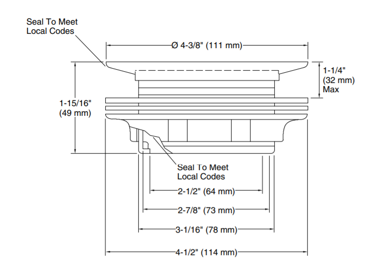

Specs here
https://www.us.kohler.com/webassets/kpna/catalog/pdf/en/K-9132_spec_US-CA_Kohler_en.pdf
Here are the dimensions for it
Question: Do I need to find a way to reduce from 2" 1/2" to 1 1/2" or there is similar parts that can fit my shower pan and that match the 1 1/2" ABS pipe that I have for the drain ?

If you read the installation instructions for the drain, you will see it is designed to mate with 2" pipe. The 2" pipe has an OD of 2-3/8" and passes through the bottom 2-1/2" opening. Then a gasket is compressed into the annular space between the 2" pipe and the upper body of the drain.

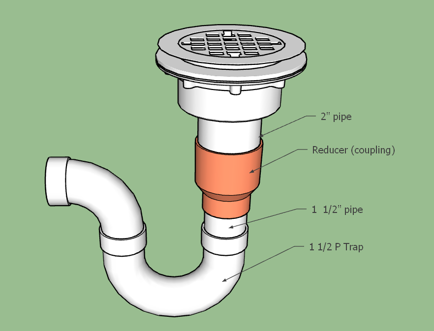

If your plumbing code allows a 1-1/2" trap and trap arm for a shower, and that's what you have, then you'd use a 2" x 1-1/2" reducing coupling on the 2" pipe coming out the drain, and then a section of 1-1/2" pipe into the trap. The reducing coupling will take up some height, so you will need to be sure that the elevations work out.

Yes, precisely. Or depending on your project details, you could use a 2" p-trap and a 2" drain line.
As to the height you'd need, Charlotte's catalog says a 1-1/2" x 2" reducer is 2 5/32" tall (including hubs). And that the center line of the outlet of a 1-1/2" p trap is 2-3/16" above the inlet excluding the hub. And that the insertion depth of pipe into that hub is 11/16". So along with the above drawing, you can figure out the result. The minimum height would be drain body touching the reducer touching the p-trap inlet hub, but it would be wise to assume at least a 1/4" of exposed pipe at each joint.
Can't reduce on the horizontal, it create a little dam at the bottom of the pipe. [Well, you could with an eccentric reducer, but that would be highly non-standard and probably not allowed.]

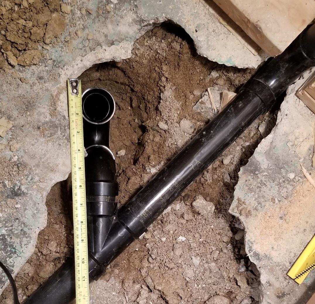

Here is a picture with some measurements
Is that a good solution?
I could try to sink the bottom piece of the P trap lower using more 1 1/2 pipe and a coupler, to make room for the coupler

As to your picture, everything there is 1-1/2"? Is the riser in the wall the drain from a single lavatory which is wet venting the shower? And does your plumbing code allow 3 DFUs on a horizontal 1-1/2" drain (assuming a shower is 2 DFU and the lav is 1 DFU)? As well as allowing a 1-1/2" wet vent carrying only 1 DFU?

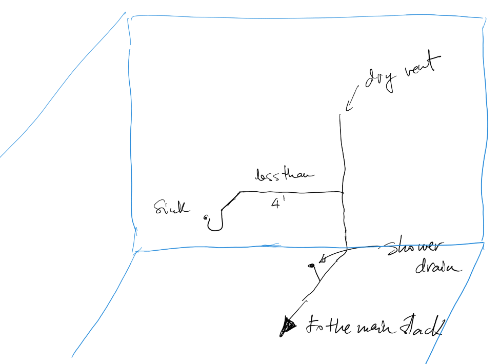

Yes everything is 1 and 1/2
Here is a setup we discussed here like 4-5 months ago or longer
You can find cleaner diagrams in our previous conversations
I ended up implementing your solution that eliminated a dry vent for the sink

I am inclined more toward this solution: interjecting a piece of 1 1/2" pipe between the two elements of the P trap in order to lower the bottom side of the P trap and make room for a reducer

OK I went downstairs and I have almost 3" between the floor level and the trap.
The reducing coupler is 2 5/32" so that leaves me with some room to install small segements of 2" and 1 1/5" to make the transition

I guess the limiting factor is the pipe in the lower right of that drawing cannot be increased to 2 inch, right?
The trap arm (Trap U, through bend, through horizontal green, to santee) must be no more than 1.8 meters. You may be able to shorten that path by not drilling through the stack of 3 studs, and instead break through the wall closer to the santee.

Edit: the distance from the trap arm to the dry vent to the trap arm is under 4'
At a 0.25" drop per 1" that amounts to a 1" drop which is less that the diameter of the pipe (1.5")
yes that is already in the ground and I did not want to break the floor too much (I hate that part of the project)
On top of that that is the original size and it worked well with that size (and a bath tub!!) , I had not complaints
It is all cut and fitted now but I did not account for this complication with the shower drain being sized for 2"
