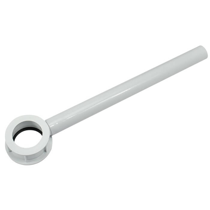

Hi everyone,
My bathroom sink fell the other day (wall mounted) and I've been struggling to think of a way to mount it back. One of the pipe broke and my handyman is claiming that I will need to buy an entire new sink as there's no fix. I really can't do this because I can't afford a new one in this economy
The sink is an ikea sink and the pipe that broke is in yellow. I can't get the spare part from ikea or eBay but are there any substitutes that can help? Any advice will be highly appreciated. Thank you guys so much.

Is the overflow a separate pipe as in the docs or integral to the sink base? If separate pipe you'll need the original version.
3,481
The Ikea drain is needed because of the overflow connection.
However, perhaps a dishwasher inlet fitting for 7/8" hose may work.
Dishwasher inlet fitting.

Looks like you can use any bathroom sink drain where most are 2". You'll need to reposition the trap some but it should work. If you want to keep the faucet you'll need a drain kit without a sink stop lever.
https://www.homedepot.com/p/VIGO-VI...nting-Ring-In-Matte-Black-VG07000MB/205613550
Should I buy something like this to reposition the trap?
https://www.amazon.com/Snappy-Universal-Drain-Bathroom-Sinks/dp/B014FULKKO
And why am I buying a bathroom sink drain if my pipe is broken? Sorry my plumbing knowledge is close to zero.
Hi Terry. Where does the inlet fitting go? Is it the black pipe that is connected to the tailpiece?

put any drain on there if it needs a hose for overflow then put a y branch tail piece.
The problem is the budget . and getting someone to help you do the work. I guess if thats Ikea check with them , some of this stuff can get shipped so fast (no experiance dealing with them) Good Luck!

Standard drain would probably block the drawers, but there are some that might work. You'd probably have get some parts and try to improvise. I'm surprised ikea can't supply a replacement. The repair would save money vs replacement in my opinion.
