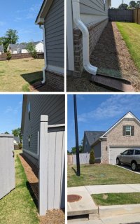

If so, I would appreciate some input to a plan I'm considering.
I have a large but low and poorly drained back yard. The two downspouts on the back of my house empty into this low area.
On the most troublesome side of the house, I want to direct the water from that backyard downspout to the front yard and out to the street.
This sidewall dimension is the longest on the house at more than 65 feet, and that sideyard is pancake flat. If I pick up the downspout water just above ground level (at the foot of the downspout), I have zero inches of natural fall in the terrain all the way to the front of the house.
The good news is that the front yard is well sloped to the street. And that front corner also hosts a downspout that produces a lot of rainwater runoff that is scouring the top soil and nutrition out of that frontyard slope. I would love to merge those two gushers and carry them in underground PVC through a curb cut and into the streetside gutter which serves a sizable storm drain.
(COMMERCIAL BREAK Here) :rolleyes:
My house is one of those that features a brick facade skirtwall along it lower three feet, and the running bond bricks are topped with a sloped cap of perpendicularly mounted bricks. All along that uninterrupted 65-foot sidewall, the top of that wall is dead flat level... but sturdy as hell.
What I'm considering is mounting a standard gutter on that top shelf and shimming it from the back of the house to the front to introduce a generous pitch and to allow that troublesome backyard downspout to drain into the supplemental gutter which will carry all of my runoff to the front corner of the house. From there, I can merge the backside runoff with the front corner runoff and carry it all underground to the street.
Sorry to burden you with one other aesthetic detail, but to prevent this unorthodox arrangement's being visible from the street, I would drop the feed down to an underground conduit just before it reaches a six-foot high gated side fence that is ten feet back from the front corner and blocks the view of that side of the house. Every thing after the fence would be hidden underground.
If you got this far, thank you for your patience. I will truly be grateful for all critiques and input.

Thanks for the thoughts, but drain tiles would still leave the rainwater in my back yard and flowing into my neighbor's.
We don't pay for runoff control. The expectation is that pop-up emitters and pipes through the curb will send storm water to the community retention pond by way of the storm drain system (see photo).
Roof calcs are done, pipe specs are known for 10-year and 100-year rainfall intensity statistics in our area. But they don't make that needless 65-foot pipe-hiding trench any shorter or any shallower. What I'm trying to solve isn't a technology problem; it's a laziness issue and an aesthetics problem.

That's what I'm planning, Jeff. It's that 100-foot trenching job mostly across hard, flat clay that I'm hoping to simplify. I'm ready to bite the bullet on the $300 core drilling at the curb. I'm even prepared to tunnel under the sidewalk. But I'm too damned old to dig
the Suez Canal.

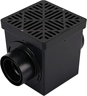

The easiest way is to add a sump pump and drain basins. On my small lot here in Florida I was adding pavers on three sides of the home and did have some standing water issues. I also did not want the run off to enter my neighbors yard since the pavers would slop to the lot line that was only 5' from the foundation. Only 10' ft between homes. On one side I only added one drain basin and three down spouts to the 4" pipe. The system drains at the raised curb by adding another drain basin. It is lower than the rest of the system so it drains over the curb onto the street.
On the other side I sunk a four drain basins with three downspouts. At the first drain basin I installed a Zoeller sump pump. It was not possible to use 4" pipe everywhere because of the slope. One the side with the pump water will puddle during the rain event but it does all drain away by the pump and then gravity. The other three basins drain the standing water.
I'm sure GA has similar summer thunderstorms showers that dump at a rate of about 1" an hour. My weather station records the rain rate. Don't try to keep the ground dry during the rain, you'll never have a large enough pipe but a system that will drain standing water.
I don't envy you trying to solve your drainage problems, man. But, as you might notice in the pictures, I'm not limited or confined by yardspace factors. I have a full quarter-acre, but the hard, impervious, terra cotta clay of north Georgia isn't nearly as forgiving as the sandy soil of Orlando. I dealt with the drainage issues of our place on Merritt Island for five years, and I can assure you there's a world of difference. I'm not trying to keep the ground dry; the rain that FALLS ON IT is more than adequate without adding the redirected runoff from 1200 sq. ft. of roof surface (rear roof only) from being added to the rice paddy of my back yard. One way or another. I'm going to get it the the front yard and down the hill to the street. The sump pump approach would be as much work--or MORE--than just digging the damned trench and being done with it. In fact, yesterday I went ahead and called 811 to get the utilities marked in the area of that inevitable and excruciating excavation.
