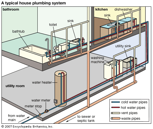

Hello, I'm not very knowledgeable about plumbing, plus I'm a student, so I don't have the funds to have my pipes checked out. I was hoping to obtain some help and thoughts on what is wrong with my bathtub. I moved into my apartment about two weeks ago, and after taking a shower, I notice a terrible odor that smells like rotten cheese but I’m unable to find the source. And the stench comes out after about 10-20 minutes of running the shower. I also get a headache after showering due to the smell and the smell takes some time to dissipate. The apartment was unoccupied for a month prior to my move in. I asked maintenance to come take a look for any leaky sewage pipes and they said the pipes weren’t connected to the sewer, therefore they wouldn't come. Not sure how true that is because again I’m not familiar with plumbing. But I did some research and I think my ptrap is dried out; I’ll attach a picture. I do believe it’s within my states pluming code to have a ptrap to prevent the sewage smell from emitting as well as a vent of some sort typically found on the roof. I’m not sure how to go about having my maintenance come check out the issue and if I’m even correct about my assumption.

A dry trap would only be temporary until it is filled with water when the drain is used.
.............. I asked maintenance to come take a look for any leaky sewage pipes and they said the pipes weren’t connected to the sewer, therefore they wouldn't come. Not sure how true that is because again I’m not familiar with plumbing............
I feel for you since the maintenance knows nothing or just trying to dazzle you to thinking they are smarter. An impossible statement. All drains are connected to a sewer or septic system and do generate sewer gas. I guarantee that this is a known problem by them and previous renters have complained about it. It probably not the maintenance guys problem but the owner of the building where no money is spent on repairs. There are many ways odors can penetrate into a room. If you're in an old home with cast iron pipes, they do eventually fail. They'll crack or rust through. As Reach suggest, sewer gas can be entering from the sink, toilet or tub drain. The pressure is high enough to push past the trap back into the room. Doubtful it is the toilet.
Does the bathroom have an exhaust fan and or window? If a window open it about an inch and an exhaust fan, keep it off with the window open. It won't fix the problem but may help to air out the room. Getting a headache could be serious and I would start looking for another place. File a compliant if possible and break the lease. I'm sure there are renter protection laws and sewer gas odor does not make it a safe place.

So there won't be standing water in the shower drain all the time? Sorry Ive been reading so much on this to see if others were having the same issue as me and assuming the shower drain should have some water when looking down into it. There is an exhaust fan and a window in the bathroom. I keep the window open to allow fresh air in and out, but the smell does not go away for at least 15-20 minutes after showering.
Also, I noticed today that my toilet water level drops immediately after flushing, and it makes a running noise for a few moments. I And water was leaking into my neighbor's apartment, so she complained to maintenance.

Is this a shower stall or a bathtub? A bathtub you cannot see the trap. A shower stall usually the trap is directly below the drain.
