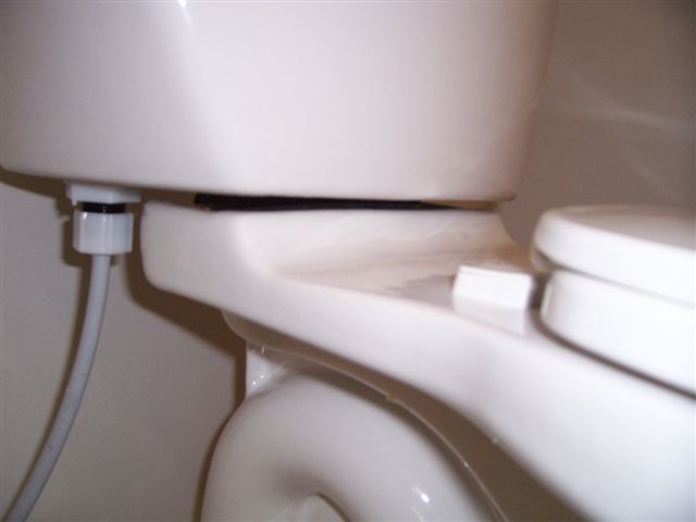

For whatever reason this tank could not be tightened as designed. I was able to tighten it so tight that the tank was on the bowl on only one side. I did tighten it incrementally but with no success. I must have tried tightening it a dozen times before I finally said ok that's enough. I returned it to Lowes.
I know the Cadet 3 are recommended by people on the board but I think that American Standard lacks a quality control department.
The other Cadet 3 that I returned to Lowes yesterday lacked glazing on part of the tank that was very visable with the tank cover in place. It also lacked a seat which was to be included. They did give me a seat but like I say I ended up returning it anyway because of the lack of glaze.
The same person handled my return yesterday handled the one today. I asked her if they get a lot of returns on American Standard and she said yes.

You are right about the quality controll but for double the $$$ you can get a Toto and not have the problems although no toilet Mfg. is perfect...some are just better than others.
I have yet to have a problem with the tank on any Cadet 3 I have installed.
The tank leaning to one side is almost always because of starting wrong.
