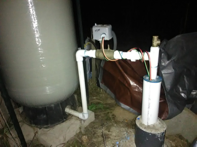

Valveman, I don't think my 200ft deep well has a bleeder valve. I was there when driller installed my well pump. He had closed the well cap then he said he forgot to drill a hole in the drop pipe so he pulled it out about 12 feet and drilled a hole in the drop pipe he said so the drop pipe would take in air for my pressure tank without a diaphragm.
Can a hole drilled through the drop pipe be used instead of a "bleeder orifice down in the well"? Would this hole through the drop pipe be called a weep hole?
Valveman, where is this "bleeder orifice down in the well" you posted about? If I change to a pressure tank with a diaphragm do I need to eliminate it?
My pressure tank stays water logged even though I drain it.We have a discussion about it here:

Drilling a hole in the pipe will work. It is just a cheap way to make a bleeder. But unfortunately it bleeds all the time, and can even drill a hole in your casing, unlike a real bleeder orifice. The check valve and schrader at the tank have to be working perfectly before the bleeder can function.

Thanks for the information Cary, but my system has a pressure tank without a diaphragm and I don't see a check valve anywhere.
38,948
4,456
Thanks for the information Cary, but I my system has a pressure tank without a diaphragm and I don't see a check valve anywhere.
That brass/bronze thing with your pressure switch downstream and the snifter valve upstream is the "tapped" check valve.

You must have a check valve and schrader to make the drilled hole draw in air. The check valve could be in the well, but usually not. It could also have a check valve and two drilled holes in the well.
Mike77
34
Texas
So the brass piece with the pressure switch and the snifter valve also has a check valve in it.

That schrader should draw in air every time the pump stops. If not the check valve is bad or the hole in the pipe is clogged. If it is not getting enough air, the drilled hole should be farther down.

I guess I won't have to pull the drop pipe. I think I found the reason for the water logging. I drained the pressure tank and refilled it. Then I sprayed soapy water all over it. There are bubbles coming out of the threaded plug on the very top of the tank. So I am going to remove it and put teflon paste on the threads and put it back in.
Then to see if the tank is taking in air like it should and to get a reference point; with the pressure up to 55 psi and the contact points open I ran a hose in to a bucket. I opened the valve and watched as the pressure went down to 25 psi and the contact points closed I had about 9 gallons of water that had run in the bucket instead of the 1.5 gallons I was getting when it was water logged.
