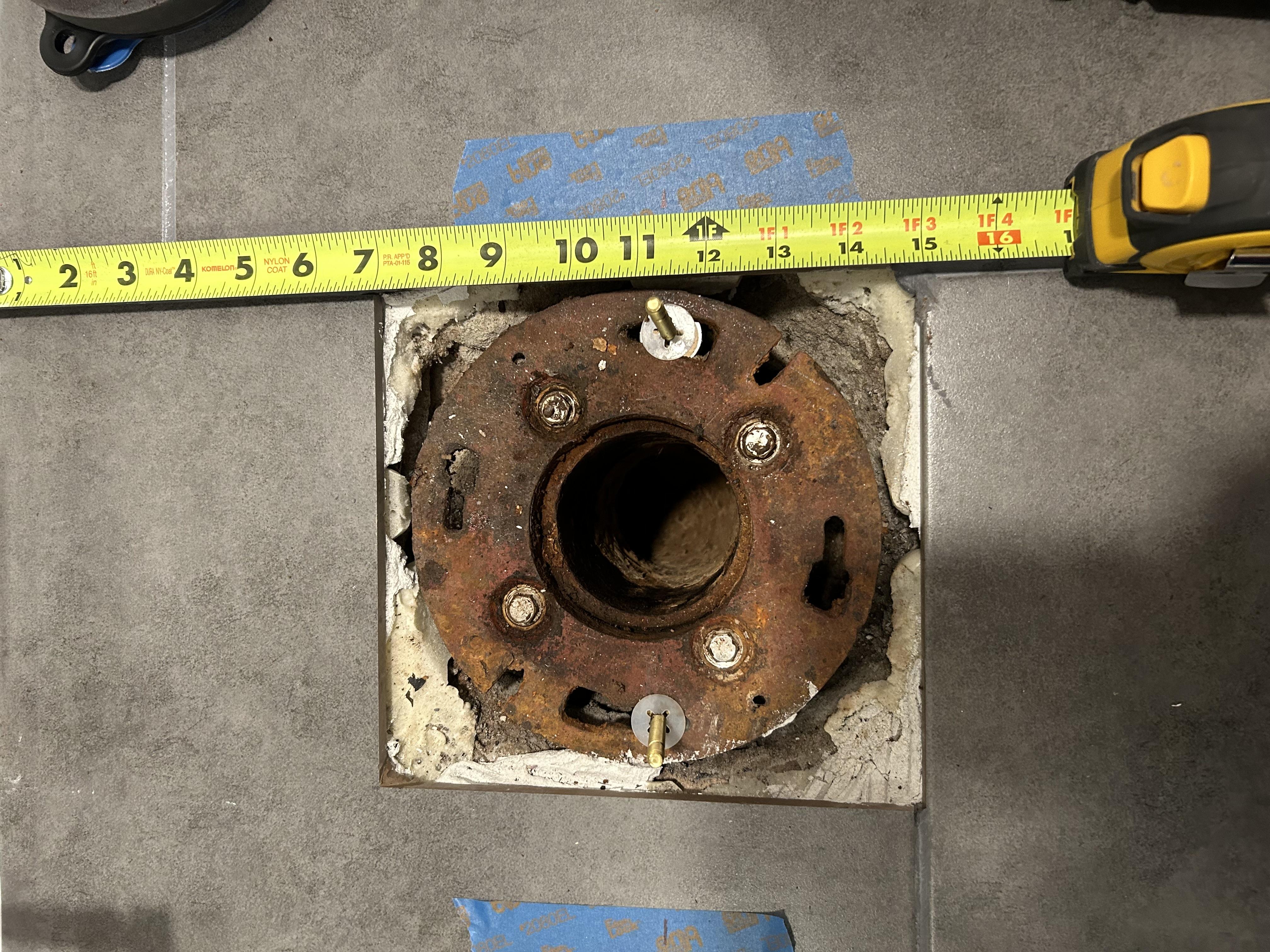

That leaves me with two questions. First, I've measured and re-measured, straight from the wall to center bolts, no baseboard, and I consistently come up with just a hair less than 11.5" rough-in. 11-3/8" as near as my aging eyes can narrow down. The Emblem's tank is right up against the wall, no gap. I've seen in the New Drake thread (here) that 11-3/16" is enough for the CST776CEFG, but elsewhere in the forum that it needs 11.5". I'd love to be able to put in either a CST776CEFG-11, or CST776CSFG-11 for the 1.6 GPF. Do you good folks reckon either of those 12" rough models would fit, or would it be wiser to go with a 10" rough (in which case I'm eyeing the CST776CEFG.10-01)?

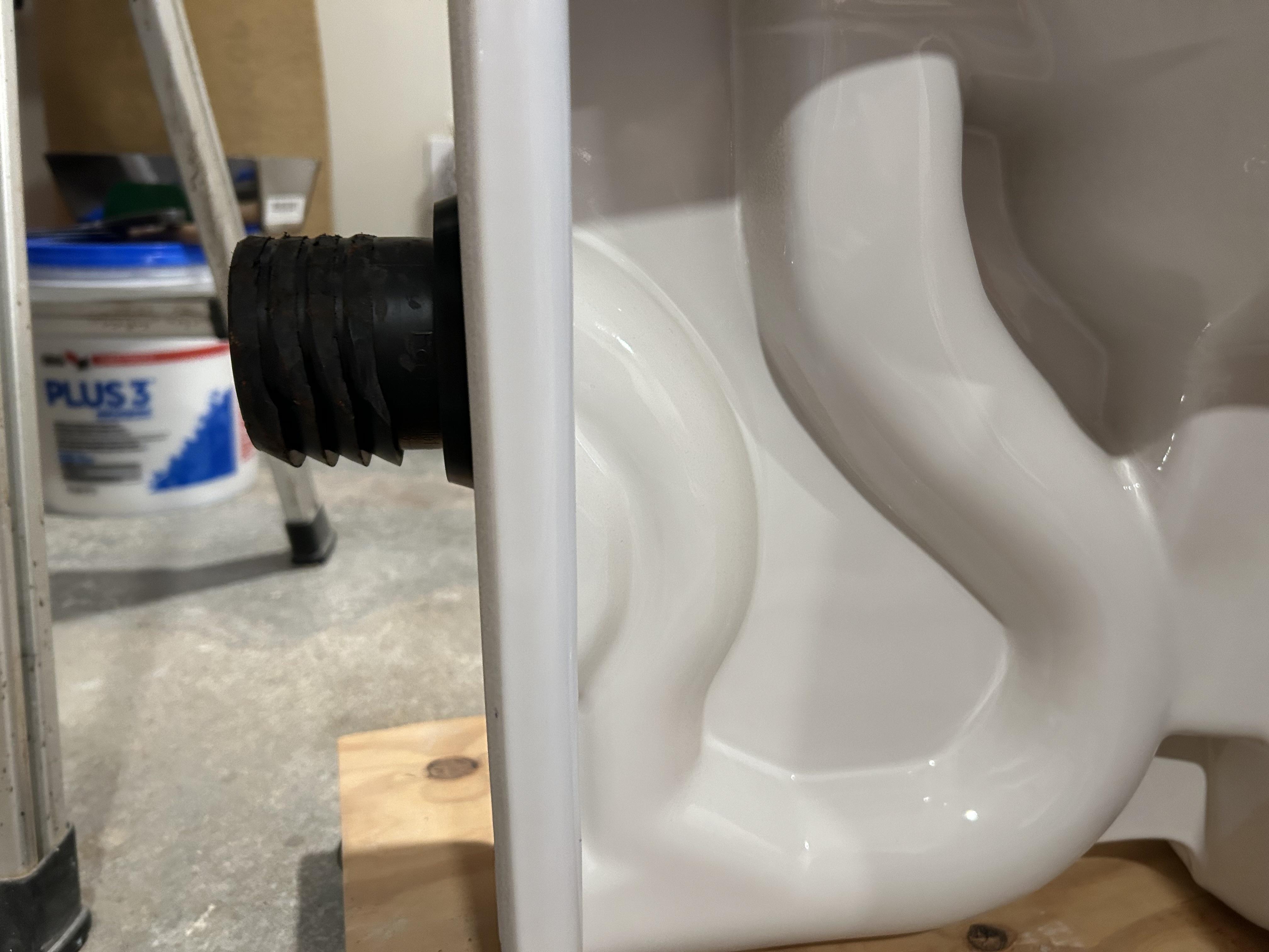

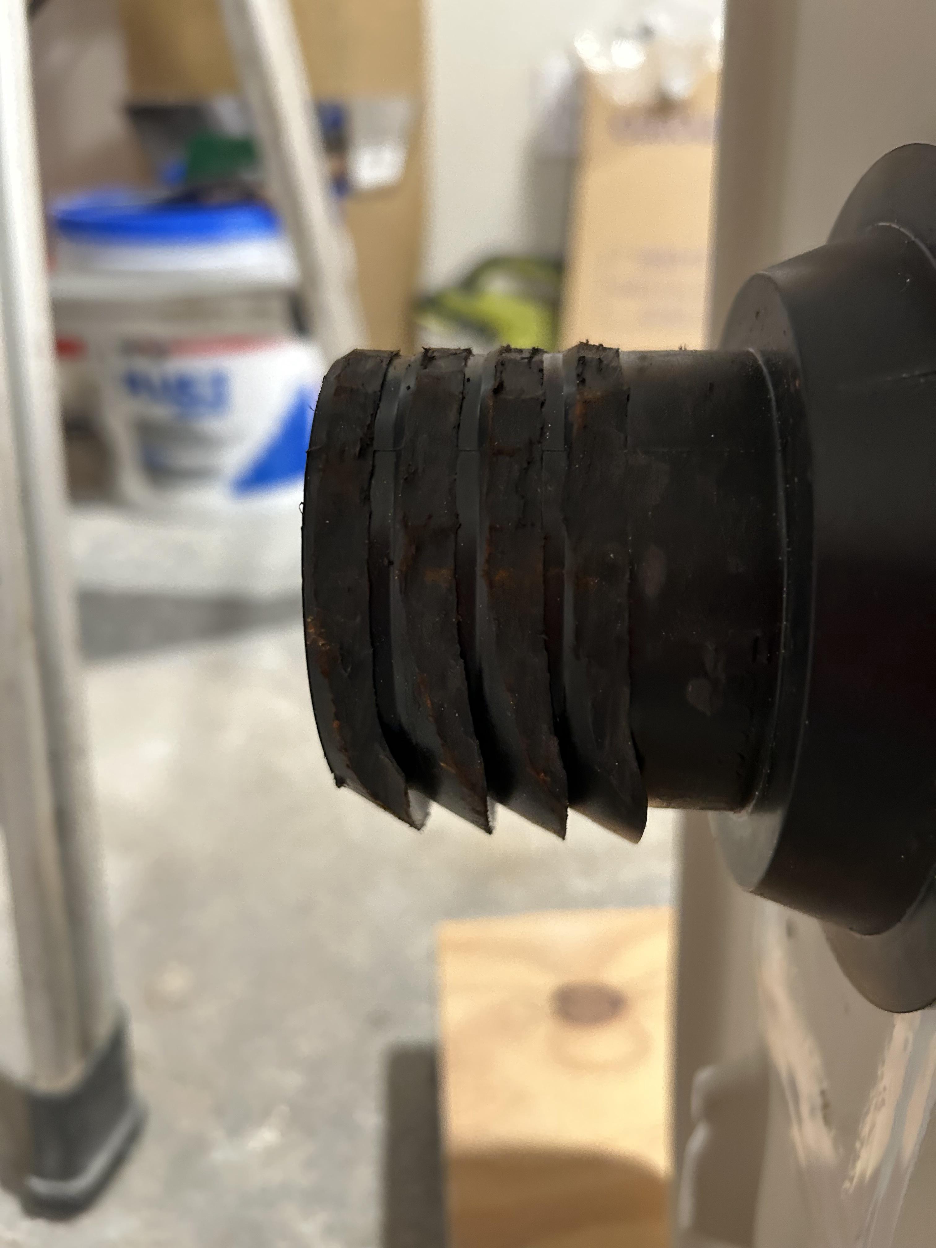

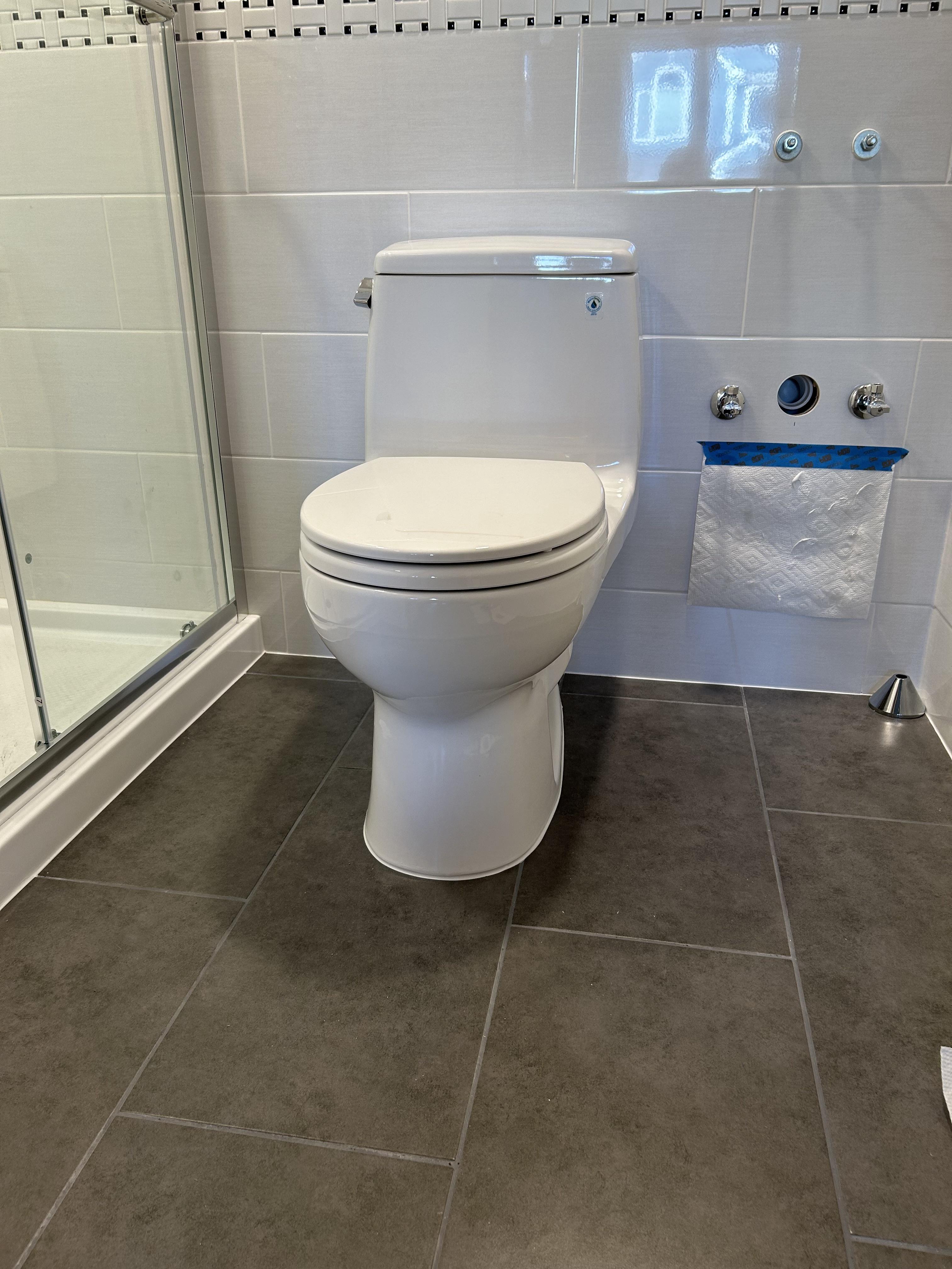

Not long ago I installed a Toto MS853113E ECO ULTRAMAX, which is a 12" center, on a cast iron flange that was about 11.5". I ended up adding stainless steel washer to the flange bolt holes, but more importantly I used a very particular Fernco product, their 3" Wax Free toilet seal.
The glue that adheres it to the toilet is beyond tenacious. Also it is somewhat elliptical in shape, so it can be moved 'off center', if you will, so that the toilet 'bell' does not have to line up perfectly with the flange hole. I also trimmed the 'fins' on the Fernco 'bell' to allow more forward placement. Here's some pictures that might help.
Note how the 'center' of the toilet seal is actually behind the center of the toilet bell outlet? That's the 'elliptical' thing I was referring to.
It all worked out nicely, and it's been functioning perfectly!
Hope this is helpful/timely.
