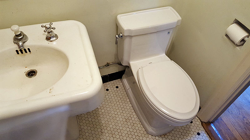

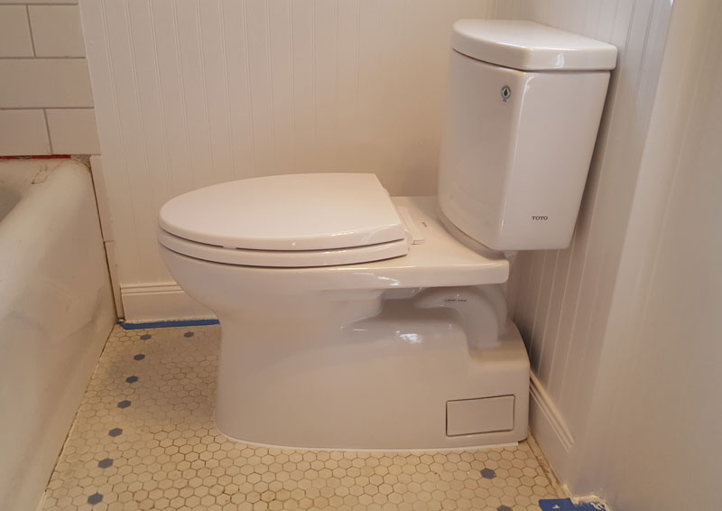

A condo from the 1920's with a 14" rough, toilet next to the door that swings in. It was just barely clearing a standard round bowl toilet.

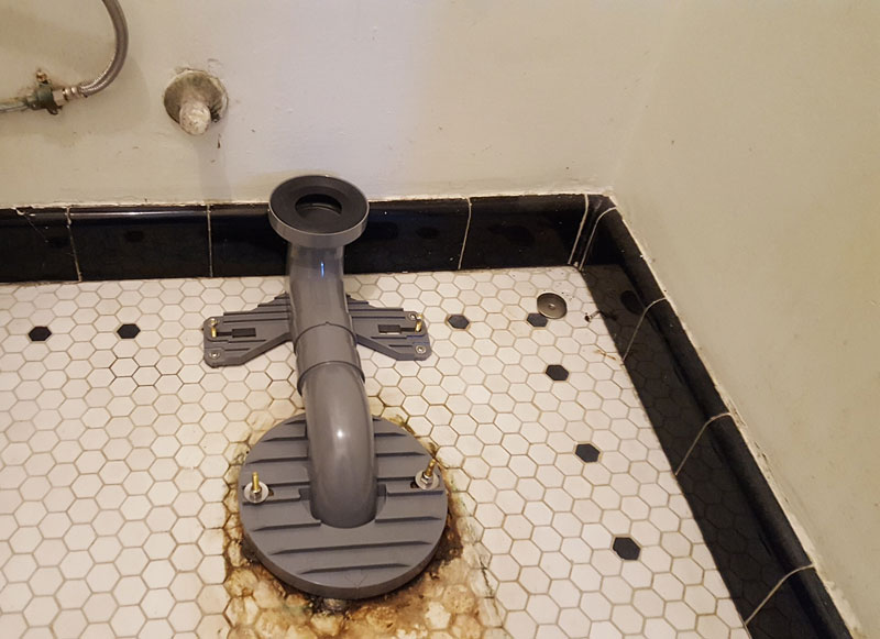

Drop a 14" TOTO Unifiit down to change the rough in and move the bowl back 2".
And then place the TOTO Guinevere over the Unifit to complete the installation.
This elongated bowl toilet, giving the homeowner 1.5" more space, also clears the door by more room. It's a win-win.

That Guinevere fits the decor nicely! Now only if the customer would be inspired to clean that sink, it could be a model bathroom!

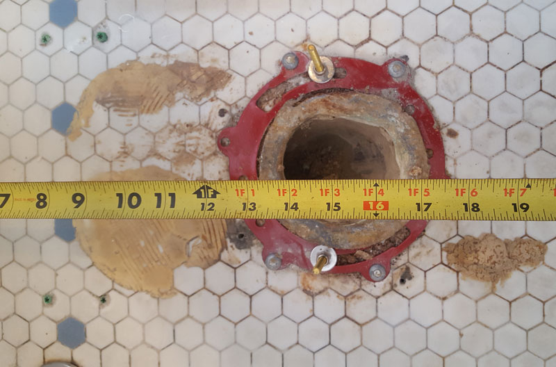

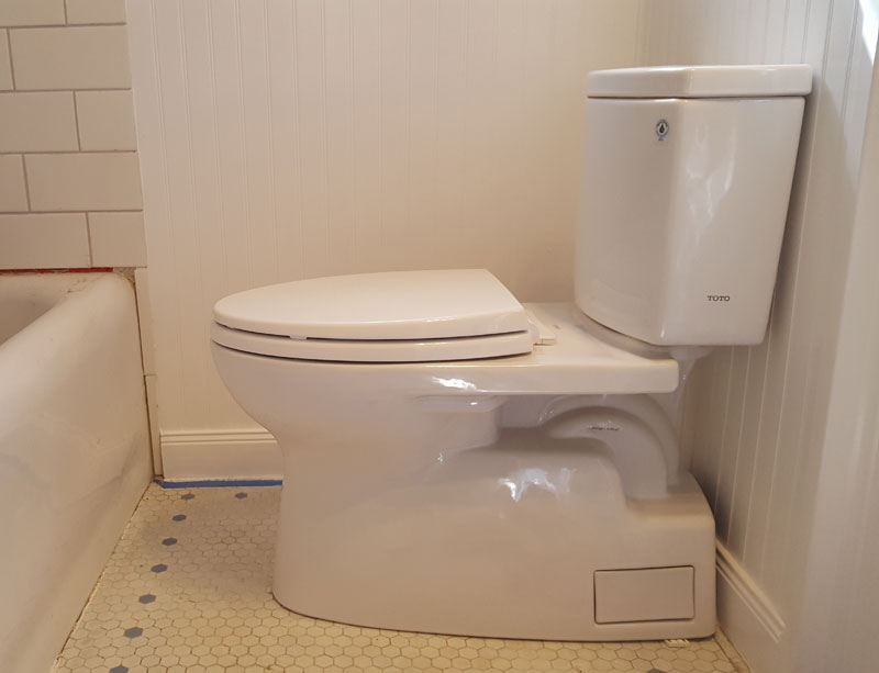

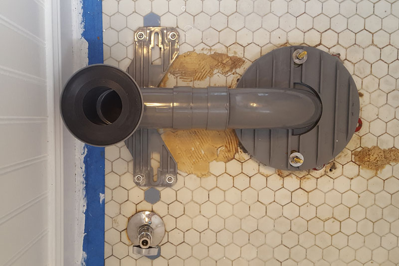

Something like 15" rough-in?
I fudged this 14" Unfit over to about 14" from the wall. It as a 4" drain, so why not?
Hey, works for me. A Vespin II with the 1.0 gallon tank that gets the rebate in Seattle.
Because of the tub, we were trying to pull it back to the wall as close as we could.
And then some clear caulking. At least it will be dry and clear in the morning.

There are now other brands that have available adapters for moving the bowl back 2"
I do install al lot of the TOTO products for this though. I had one home we installed at that had 10", 12" and 14" roughs.
So we set one with a 10" unifit, one with the standard 12" they come with, and one with a 14". Same toilet, three different roughs, and all the same distance from the wall.
