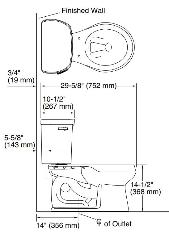

The center of my toilet flange is 15" from the finished wall in my bathroom. I replaced the toilet about 5 years ago and had no clue about rough-in sizes, so I grabbed any old toilet off the shelf from the big box stores. Well, after installing I noticed the whole thing was off the wall several inches and looked ridiculous and also took up space in my very small bathroom. That's when I realized I picked the wrong size.
It appears from my research that a 15" rough-in does not or has never existed. So am I correct in thinking a 14" would be the best choice for me?
Issue #2 for me is I need a toilet that will not get clogged...and after reading on here, the Caroma seems to be the top choice because of the 3" or 4" trap. I also saw that we may be able to get away with a Kohler Highline with the "Pressure Lite" flushing technology. It seems that the box stores only have 12" rough-in.
I suppose my question is; What is a good website to order a toilet from?
Unless you're willing to try to move the toilet flange, get as close as you can get, and that's a 14" RI toilet. Note, depending on the toilet, that may just come with a deeper tank, leaving the bowl sticking further out, but solves some of the space behind issues. A Toto toilet that uses their UniFit adapter (not compatible with other brands) uses the identical toilet and moves the toilet so it stays the same distance from the wall because of the adapter.

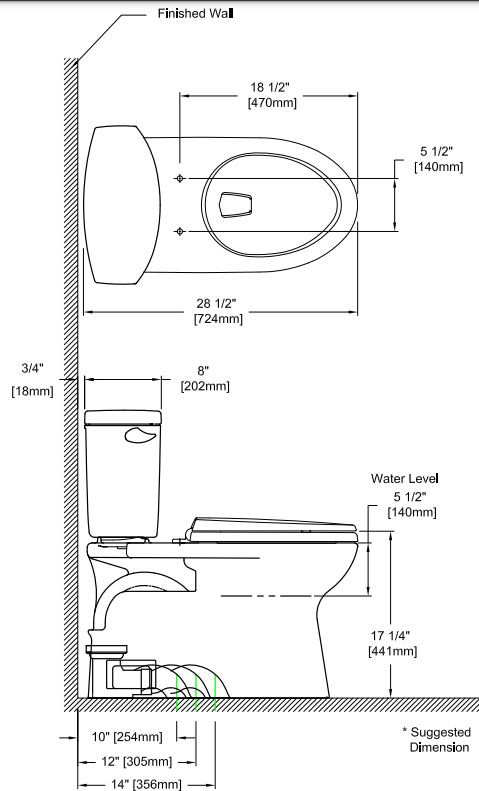

Like Jim mentioned above, TOTO makes bowls that come as 12" but can convert to 14" with the Unifit adapter.
The TOTO Vespin II would be 30-1/4" to the end of bowl on a 15" rough with the adapter. It also moves the sitting position 2" closer to the wall.

The gravity Highline would be 33-1/2" to the end of the bowl on a 15" rough.
30-1/4" from wall to end of bowl on a 15" Rough
TOTO Vespin CST474CEFG

Consider a Vespin II with a 14 inch Unifit. It is the least expensive of the Unifit toilets, and it sticks out not too much. There are other Unifit toilets, and you may like one of those better than Vespin II.

So how does this apply to you? I used a 12 inch Unifit adapter on approximately a 13 ft rough-in. You could do something similar by using a 14 inch unifit on a 15 inch rough-in.
So it sounds like Caroma and The Highline are out of the picture for me unfortunately. When you say 33-1/2" to the end of the bowl, does that mean from the finished wall to the tip of the bowl?
