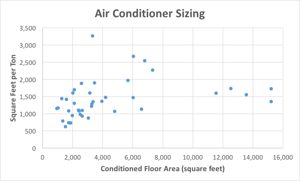

A 2.5- 3 ton system for a ~1400' house that has fluff in the attic & walls and glass in the windows is a case of ridiculous oversizing, at a ton per 45-550' of space. Most homes that size would do fine with a 1.5 ton or AT MOST 2 ton ducted mini-split, whether new ducts or re-commissioning the old ducts. A 2 stage 3 ton unit that's 2x ovesizd for the load at the high stage is also substantially oversized at the lower stage.
Below is a graphic plotting calculated Manual-J cooling loads for dozens of houses, compiled by a home efficiency contractor in Georgia:
Not even the WORST performing house was as bad as a ton per 550', and most houses in your size range came in between a ton per 1100' & 1500'.
For the kind of money you're talking it's worth paying an engineer or RESNET/HERS rater to run an aggressive Manual-J load calculation before picking the equipment. NOW is the opportunity moment to get it right, and oversizing the equipment by 2x or more is going to cost more up front, and provide lower comfort.
In California the latent cooling loads are negative, which means you can do just fine with a high SEER ducted or ductless mini-split. Since the old ducts are probably WAY oversized, the static pressures should be low enough to use all but the wimpiest mini-duct cassettes. You may have to install a large pleated filter (Aprilaire 2400 or similar) if pushing the static pressure limits, but some have more blower power than others. The smoothly modulating (3100 BTU/hr - 20,000+ BTU/hr) 1.5 ton Fujitsu 18RLFCD can probably handle both the heating and cooling loads, with more than 20,000 BTU of heating even at +5F, at a higher comfort level than any 2-stager, and even with new ducts would come in under $8K in my neigborhood (YMMV). It has an SEER of almost 20, and a respectable HSPF efficiency north of 11. They have a line of mini-duct cassettes with even beefier blowers and bigger sizes too, if a Manual-J load calculation suggests it's really needed.
Since your contractor seems to support Carrier, note that Carrier now has some decent modulating ducted mini-splits (manufactured by Midea, using Toshiba's compressor technology). The modulating 1.5 tonner has very similar efficiency specs to the Fujitsu 1.5 ton, and would also probably cover your load.
It's worth peeking at Nate Adams' chapters & videos on home comfort, and HVAC 101 & 102- bigger is the opposite of better, and RIGHT NOW is the opportunity to get it right. While Nate is operating in a much cooler climate than most of CA, the principles are universal.

It's too much equipment for the loads, and too much money for that (likely way too) much equipment. Even a half ton ductless head is usually oversized for an individual bedroom, and OBSCENELY oversized for the heating and cooling loads of a bathroom.
In my area name-brand cold climate (= more expensive) ductless runs less than $4K/ton in competitive bidding, but I recently got a budgetary quote over the phone that ran about $8K/ton (which I of course didn't bother to follow up on.)

Unfortunately a strategy the "... have them come out and give me a quote..." strategy doesn't work very well in terms of getting right-sized equipment at a fair price.
Break it down into three steps:
1: Get a load calculation from someone other than an HVAC company, even if you have to do it yourself. There are no rocket scientists wasting their careers doing Manual-J calculations- this is do-able, and there are free or cheap tools online or downloadable that deliver reasonably accurate numbers if you are reasonably aggressive about the inputs.
For a fee you can have an independent RESNET rater or engineer run those numbers using industry standard tools. When searching the RESNET site for providers in California it came up with this:
CHEERS
1610 R Street
Suite 200
Sacramento, CA 95811
Phone: 800.424.3377
Email: jhodgson@cheers.org
Contact: Jim Hodgson
Accreditation Identification Number: 1998-199
Date of Expiration: December 31, 2020
2: Figure out a few models that will cover those loads, with no more than 1.5x oversizing (if possible.) If you're thinking about mini-split (ducted or ductless) solutions, searching the NEEP database can narrow it down pretty quickly. NEEP only lists heat pumps that have a specified capacity at +5F and lower, and will miss a number of solutions that could still be appropriate in your climate- some products have extended temperature tables that stop a +14F/-10C, which may still be appropriate, given Sacramento's 99% outside deign temp of +34F. Post a scan of the Manual-J summary page here and I may be able to come up with solutions that are slightly less expensive (though usually slightly lower efficiency) than the NEEP selections.
3: With a Manual-J report and a few model numbers that fill the bill, then start soliciting quotes, and let the contractors in on your load and suggested model numbers There will be pushback from the contractors- most will want to up-size, some will want to use a different model or vendor, and while it's fine to listen to them, do your research before signing any contracts. Not all heat pumps are alike- most true cold-climate mini-splits use variable speed vapor injection scroll compressor technology that offers both higher efficiency & higher capacity at the temperature extremes than simpler compressor designs.
Contractors who understand that you've educated yourself a bit, know what you want, and know that you are putting it out to competitive bid are more likely to respond well, better than if they're dealing with a clueless client who doesn't really care as long as they're cool enough in summer and warm enough in winter. The vast majority of homeowners really don't have any experience with the comfort levels (and efficiency) that right-sized equipment can deliver, and fall into "bigger is better" thinking, something that HVAC contractors won't argue with, since delivering that education takes valuable time, and results in a smaller sale. Watch the videos in on Nate Adams' site (the links at the bottom of response #2 above) as a primer as to why bigger is the opposite of better.
