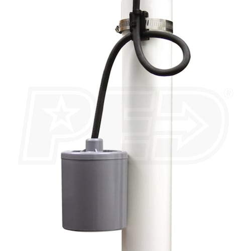

Attached the quotes below. 1st one the DAB divers pumps are $3800. I think I read in one of your posts that there was some worry with turbulence in tank causing rapid cycling of the float and subsequently the pump.
Is there a float style that removes this risk?
Just don't plumb the discharge into the tank where it makes waves.
