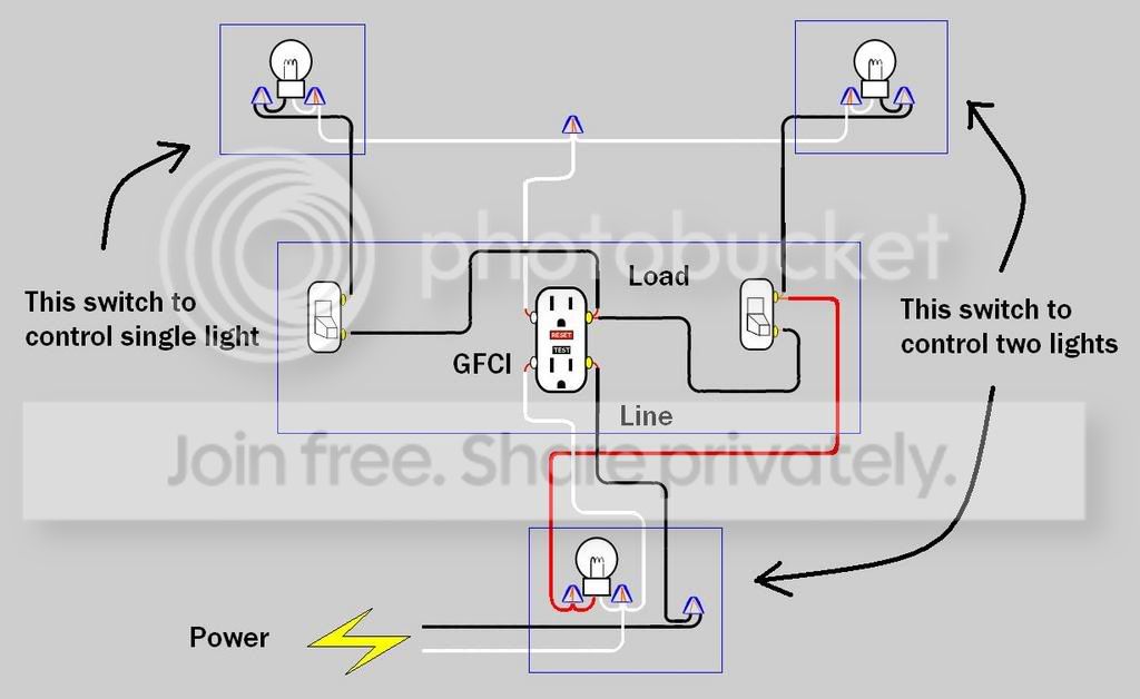

    I just remodeled my bathroom. I am not an electrician by a long shot although I have done hundreds of receptacles and switches. When wiring gets complicated though it gives me a headache. Here is a drawing of the wiring in my bathroom. I added the light in the upper right hand corner. The rest of the wiring and fixtures already existed. Although the light in the upper left is really a fan but not that that matters. The only other thing I changed was the receptacle to a GFCI. My current problem is the light at the bottom. When I connect the red wire to the switch and turn on the switch it trips the GFCI. When I unhook the red wire then the light in the upper right works fine but that disables the light at the bottom. Everything but that one light works fine without the red wire connected. The GFCI works properly, the fan and the light in the upper right. Where the heck am I supposed to connect the red wire to so that it does not trip the GFCI and works properly?
    Thanks for help!

    Have you tried pig-tailing the load side neutral down to the bottom light to see what happens instead of using the line side neutral?

    The light on the bottom is where the problem needs addressing. Notice that the white (neutral) for this light is picked up from the line side of the GFCI but the hot is coming from the load side of the GFCI.
    Unless the lights are required to be protected by GFCI I would connect everything to the line side of the GFCI. This is the only way to have bottom light work with the neutral being tapped from the supply to the GFCI

    GFCI compares the output on the load side with the return on the load side. If they aren't within very close (milliamps) of each other, it thinks some of the current is leaking (possibly through you!) and trips. As indicated, you need the lights to be wired to the same side of the gfci, either load or line depending on whether you need or want the lamps protected. Normally, the lights are separate from the gfci so if you trip it, you don't lose the lights at the same time, but this is up to you.

    The lower light, the one fed power on the red line, has power ( hot ) from the load side of the GFCI, but the neutral bypasses the GFCI, hence the GFCI thinks all the current through that light bulb is actuall going to ground.,

    You need to pigtail a couple of jumpers off the hot and neutral entering the receptacle box and connect them directly to the GFCI. Don't route the lamps through the GFCI. I am pretty sure you are only supposed to protect other receptacles using the GFCI, not lamps.
    It looks like the reason you are tripping is because the neutral of the bottom lamp returns to the input side of the GFCI but the hot for the bottom lamp comes from the output of the GFCI.

    Guys...thanks for all your comments. Yes I was trying to have the lights protected by GFI because one of the lights is located on the ceiling about a foot away from the tub. I was told by an electrician that code in my area is any light within 6 feet of the tub should be protected.
    So is there no way to have the bottom light protected in my situation? If not then I guess I don't have any choice but to wire everything to the Line side like you all suggest.

    Sure there is, but you need another conductor to bring neutral from the load side of the gfci back to that light. ANother way would be to get rid of the gfci altogether and replace the circuit breaker with a gfci breaker.

    Of course there is, just run a neutral from the load side of the GFCI to the light so both of the light's wires are on the same end of the GFCI.

    The only way to do this would be to run a new cable with BOTH neutral and hot. You cannot simply run a neutral by itself.
