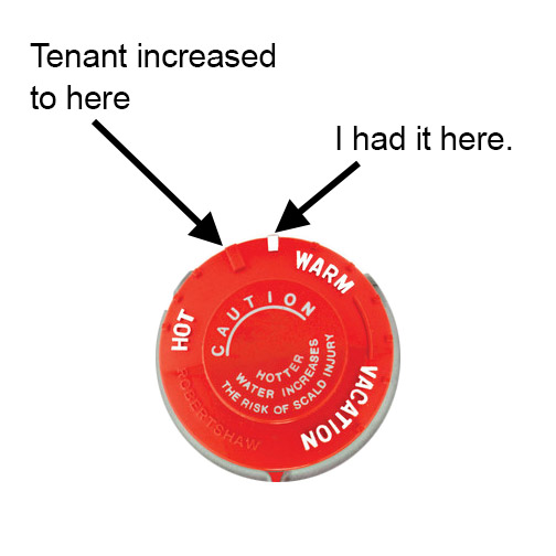

Just wondering if this sounds like something that would concern you...
Tenant increased the gas water heater temperature on the thermostat recently because she wasn't getting hot water fast enough in the bathroom furthest away from the water heater. It's about '5 minutes' past the optimal temperature line marked on the dial.
Water is nowhere near boiling hot, but I'm wondering if that's enough to cause the TP valve to open.
It let out a small puddle of water.
Does this sound like normal function to you? I mean if someone turned the dial all the way to HOT, would the TP valve open frequently?
There are no shut off valves or expansion tank on this water heater.
I'm in los angeles county.

What is your water pressure ? Are you on city water ?
You may want to install a expansion tank. The valve opening is not normal, But it is doing its job.

IMO, turning the temp setting all the way to hot should not be a problem. That is still within the operating range of the water heater. It sounds like the TP valve is starting to go bad, or you should have an expansion tank and don't, or if you have a tank maybe it is bad (full of water/no air).
33,603
1,042
If it releases a "little water", then it is probably a thermal expansion issue. If it were temperature, it would release a "LOT of water" and do it for an extended time period.
38,885
4,434
It may well be that you have a check valve on the water meter or that you have a pressure reducing valve (PRV). If so, you should have a temperature expansion tank.
You can get a pressure gauge with garden hose connection and a "lazy" / "tattletale" hand that will record the peak pressure. If you get that you may find that the pressure rises after a shower to 150 PSI. The amount of rise will be proportional to the temperature rise at the WH of the water at the end of the shower until the WH flame turns off. Hotter makes more rise.
Cure is to have an expansion tank installed, and have a shutoff valve put on the intake water at the same time. 1/4 turn ball valves are preferred. http://www.amtrol.com/media/documents/thermxtrol/MC8520_08_14_TXT_Sizing_Chart.pdf has a selection chart at the bottom. You will note that the water heating temperature is a selection factor. Therm-X-Trol is a top brand, but others make decent tanks too.

The T/P expansion valve has 2 functions. One is to prevent the tank from exploding if the temperature get too high. That's not your problem here. The other function is to release excess pressure. Excessive pressure is caused by having a closed system. The is when you have a check valve or pressure regulator valve in your system. A check valve will prevent the extra pressure caused by you water heater doing its job of heating. Heated water expands. In an open system (not check valve) this expansion is absorbed by the city main, but in a closed system, the expansion has no place to be absorbed, so the T/P opens and released a relative small amount of water to get the pressure back to normal. This sounds exactly like the situation you have. A thermal expansion tank provide a place for this expansion to be absorbed. It is possible, but not likely, that the T/P valve is faulty.

I'll check the pressure again. I checked a few years ago, and i think it was in the 40's. I don't expect it to be different now. There's definitely not excessive water pressure inside the house.
this is an old Rheem water heater, at least 15 years old. It's been chugging along without an expansion tank for so long.
Faulty TP valve?
I opened the valve lever, and it let out a tiny bit of air and a bunch of water. Then I closed it, and no leaks.
I assume that's normal.
Also, I definitely do not have a pressure reducing valve. I have one on my own home, but not this rental. So maybe there is a check valve at the meter. This rental was built in 1966, so I would have to dig the dirt in the meter box to see if there is a check valve.
I just needed to ask if I could defer maintenance, since the TP valve seems ok, and there's no flooding.
As far as plumbing goes, nothing has changed in the last 15 years in this home, and so far it's been ok till now. I'd prefer to save my money for now if this isn't a serious situation.
When you have a closed system (a check valve or a PRV...if your static pressure was in the 40# range, you probably don't have a PRV!), after hot water use, that colder water that went into the tank eventually gets hot, it expands, and because the pipes are not elastic, the pressure can easily spike...the hotter you make the water, the more it expands, which is probably why you didn't notice it beforehand. To me, it sounds like a classic symptom of needing a working expansion tank which gives that heated water a place to go.
