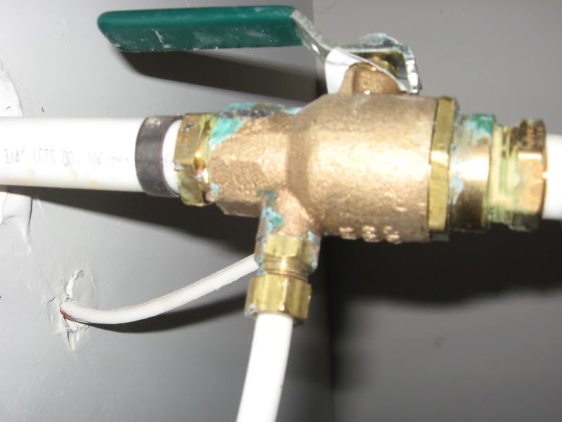

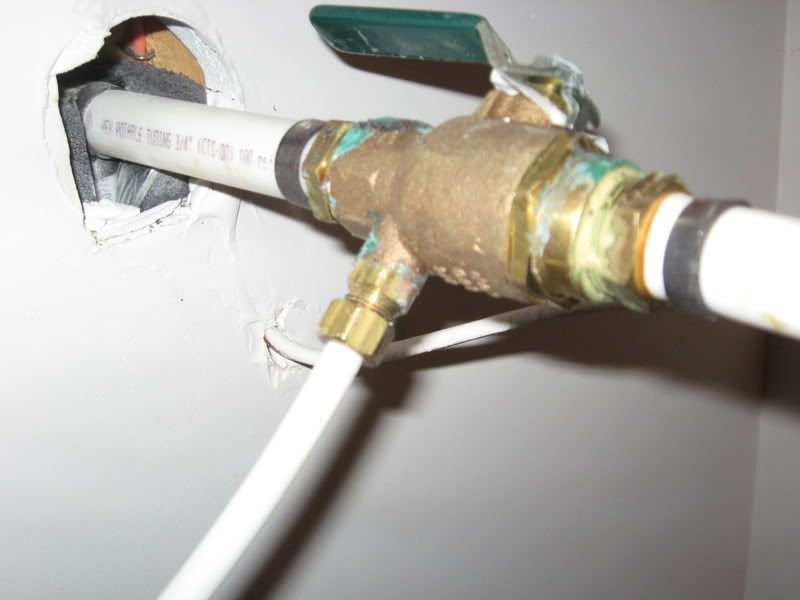

Hello, my name is Rod. Thank you for taking the time to assist me. Please forgive my ignorance of water heater know-how. This is precisely why I request your assistance. (smile) Firstly, I do not know if what I refer to as the "overflow" is indeed an overflow. But, it is definitely attached to the cold water inlet. I recently had my water heater wrapped and noticed some water underneath it yesterday. Not a lot of standing water, but enough to tap your finger against it and make a small 'splash'. You can see in the photo the area beneath the drain valve I had wiped dry. I unwrapped the unit and proceeded to trouble shoot- the drain valve was dry, as well as the TPRV discharge tube. But I did notice moisture coming from a 1/2" PVC tube connected to the cold water inlet.
This is what I refer to as an overflow, if that is correct. I wiped the area dry and directed the PVC tube into a bucket. I checked the bucket 24 hours later (today), and it had about an inch of water in it. The area around the base of my water heater was dry. So, the water heater itself is not leaking.
Of course, the water came from the PVC tube attached to the cold water inlet.
If this is an overflow, please enlighten me on how it is activated, and how often this should occur.
If it is not an overflow PVC tube, please educate me on its purpose along with anything I should be concerned about.
Thank you for your time.
-Rod

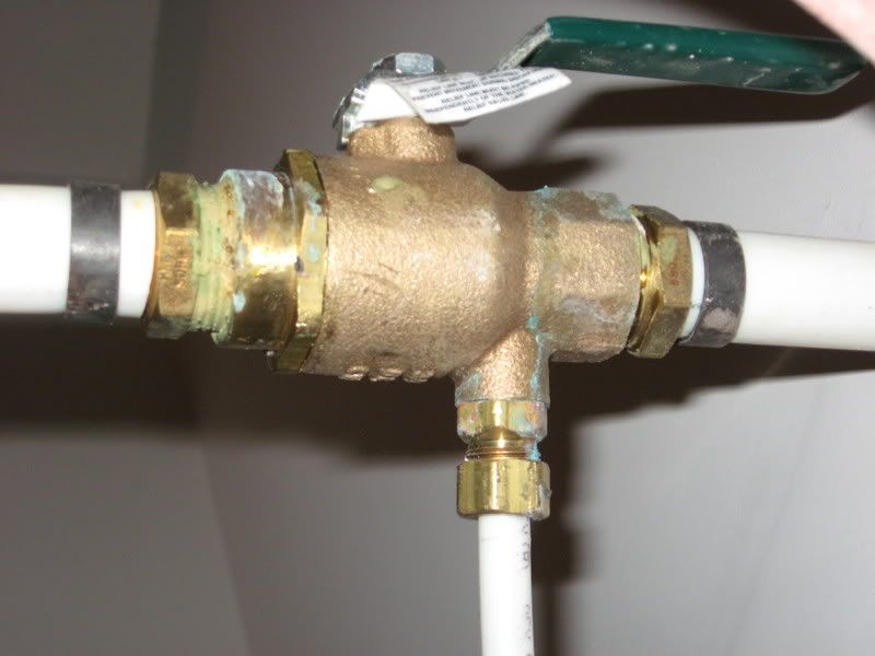

Hopefully these will help for you to explain my problem. BTW, I purchased my home new in 2005. There have not been any mods to the unit since then.
This tube should not be leaking, huh? A course of action is appreciated.
Thank you!
-Rod

ok I have to say this is the first time I seen a valve like that. At first I was thinking it was a stop and waste. But if it where a waste drain off wouldn't water come out of that constantly like full flow. I hope the other guys can enlighten this young Chicago boy on that valve.

In my research, the only 3-way ball valve I could find with a plastic tube coming down is for winterizing hot water tanks in RV's. The tube somehow sucks antifreeze into the tank from a bucket. But my guess is, you don't live in an RV. :)

That's a Watts Thermal expansion Ball Valve Shutoff.
It's dumps water when thermal expansion is present, or is malfunctioning which could easily be the case.
Hard pipe copper out of that tank on the cold side, tee off and install a thermal expansion tank and get rid of that valve, install a normal ball valve.
Then reconnect back to that PEX.
Before you do any of this, check your static water pressure at a hose bibb and determine what the pressure is incoming.
If it is above 60, near 80, you got other problems as well.
An expansion tank will provide protection to as little as 1/2 pound of deflection on the bladder, that cannot be achieved with that valve, which is not good at all for the life and longevity of your plumbing system.

My only guess is that the installer was too cheap to install a ST5 expansion tank and use an expansion valve instead. I think I would remove the valve and install a standard ball valve along with a 3/4" female tee and an expansion tank instead.
