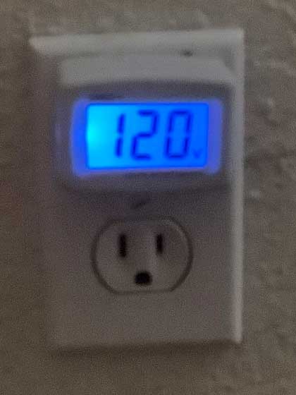

Having a 4 volt drop (120 vs 116) on one leg at the at the meter on a 200 amp service with a 15k btu a/c on is not normal. That points to an issue with the power feed to the house. My remote vacation cabin has a 200 amp service. When my 3-1/2 ton 42k btu air conditioner runs and my 24 amp 240v electric vehicle car charger is charging I barely get a 1-volt drop. Call your power company back, run the house AC and your RV ac and have them measure the service feeder voltage drop.
I have several of these digital plug in voltage monitoring devices at my home and also in my RV. Here are before and after readings I just took with the vacation cabin 3-1/2 ton ac running and my electric car charger working.
As Worth stated, changing the breaker at the house to 50a and putting a sub panel out by the RV will not change your voltage drop issue. Personally I would do that anyway just so you have a disconnect right by the RV 30a outlet and you can add additional devices if needed.
I also suspect your RV “inverter” is actually a converter. Inverter takes your 12 volts DC and provides 120 VAC so you can run 120vac appliances, TV, etc off your battery when boondocking. A converter takes 120 VAC and provides 12 v dc to keep the RV battery charged and provide 12 v dc to the RV dc devices like your 12 v dc LED lights, slide motors, exhaust fans etc.
